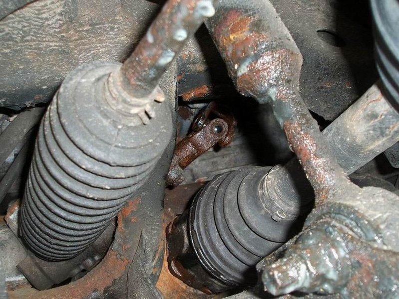

    this just started on my 05 about 2 weeks ago, its a real pain in the ass... steering wheel is super stiff for the first like 2 inches of turning to the left or to the right, but after that initial turning it becomes smooth again. this happens at any speed... gonna spray the shit out of it this weekend with fluid film, maybe slap some grease in there...
    saw this thread
    https://www.tacomaworld.com/threads/stiff-steering.122153/
    good picture from that thread:
    07 sport 4x4 likes this.

    Holy rust; I say get some grease and grease the heck out of that steering column just keep it all greased up; create a nice layer to prevent salt and what not to get on it.

    how hard of a job is it to replace? ericthecarguy's video was pretty informative, i know for a fact that its going to be "rust-welded" at both ends
