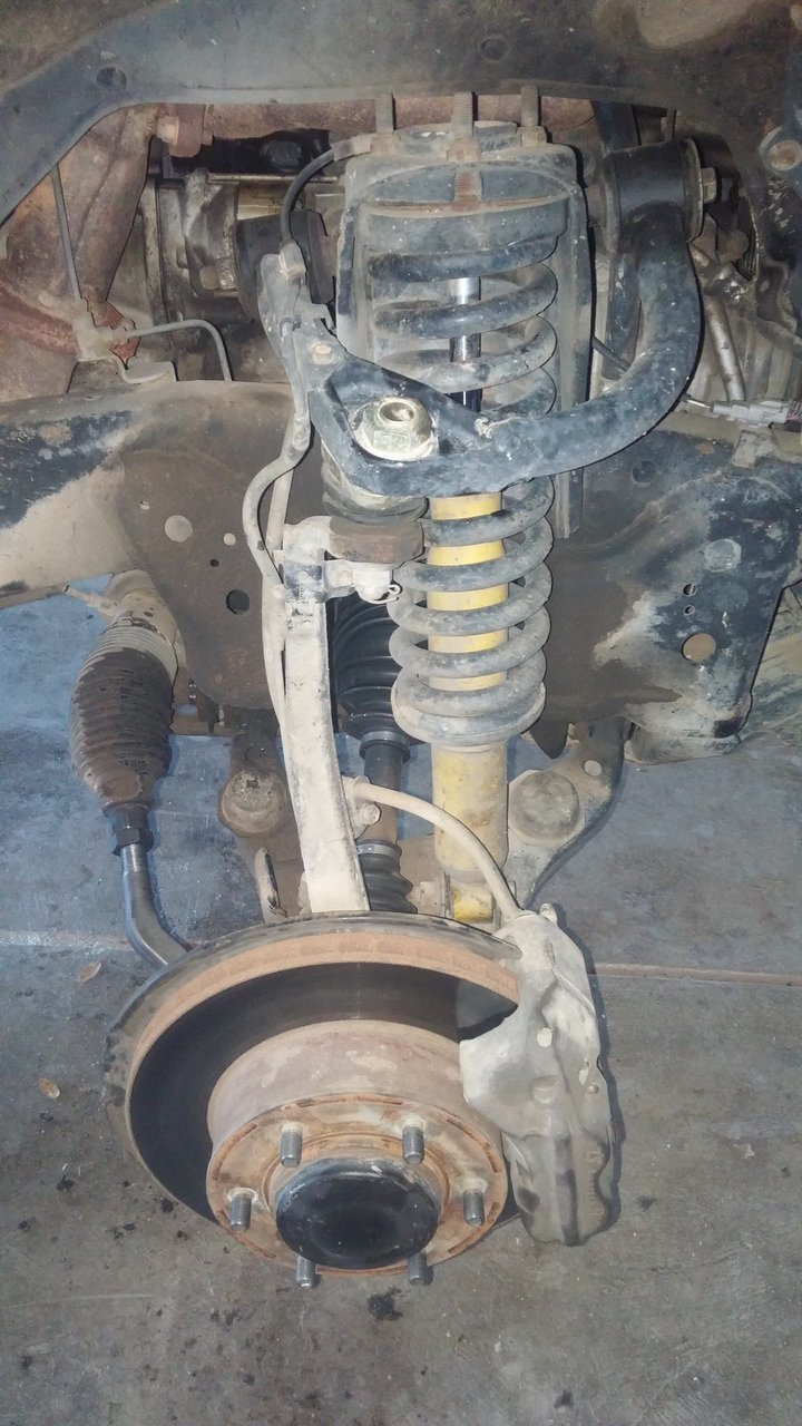

    My fork in the road: Should I replace or try to adjust the rack and/or remove the lift? I have pictures of my F/R suspension if it helps.

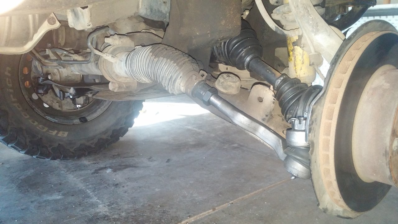

    All the grease is from blowing CV's. Notice the tie rods are at an angle relative the to the rack, from the lift. I can't help think it's contributing or causing the problem.

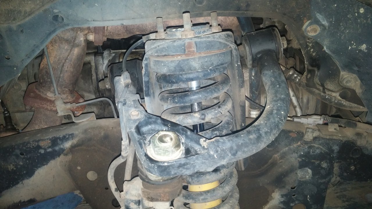

    Those are aftermarket UCA. Lightracing from the looks of it..

    Generally, the consensus is that anything over 3" lift you should be doing a bracket style lift, which prevents those crazy angles for the TREs, not to mention your CVs.
    Anything over 2.5" and you should have a diff drop kit on there (unless you have the bracket style lift which drops the front diff. That's why your CV boots are blowing.

    I was going to mention that the angles of the tie rods in the video look a little too far for their own good. not exactly the pitch angle but you want them as straight as possible horizontal to the rack itself. this could be a factor in the "wander"

    I would see if you can adjust those SPC upper arms you have to dial in more caster. More positive caster will minimize the amount the wheels steer you and lighten the force it takes for you to steer. With lifts we typically shoot for +2 to+3 degrees of caster.
