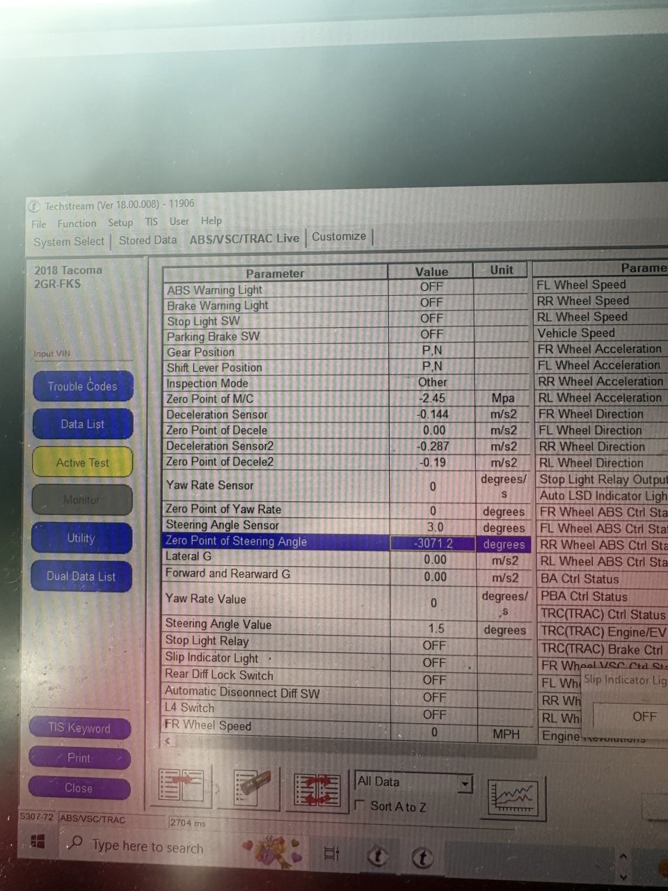

    Got this innova 5120 scanner off Amazon and attempted to clear ABS codes c4133 “ steering angle, internal circuit”. Erased code but it comes right back after clearing it . I don’t think with a 5120 you can perform a zero point recalibration. The only “service / reset” option the 5120 gives you is oil reset. You need a different scanner to actually re zero or reset , maybe like techstream (or innova 5610) ? pretty sure the steering angle sensor itself is fine. The error popped up after changing steering rack bushings. Everything was fine before that.

    Yea, I cleared my codes but now the code reads "steering angle sensor operated too long without initialization" or something like that. Would be nice to know what the initialization process is. I've read like "with ignition on, car not running, turn all the way to the right, hold it for 5 seconds, turn all the way to the left, hold it for 5 seconds, then back to center" turn off ignition.....still get errors after about 5 minutes of driving.
    I'm going through the painful install of Techstream, now looking for the best cable....

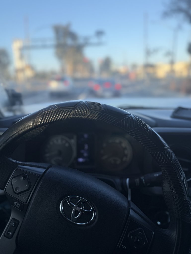

    My situation
    I reinstalled my front icon 2.5 shocks with the goal to have an alignment immediately after. Driving to the shop, I had severe pulling to the left. I had to hold the wheel about 20-degrees clockwise to compensate and go straight. (Photo attached)
    About 3 miles in, the VCS message appears on the dash, pre-collision detection shuts off, and I get a message to bring it to the dealer.
    I get the alignment and everything is good and straight but the warnings were still persistent.
