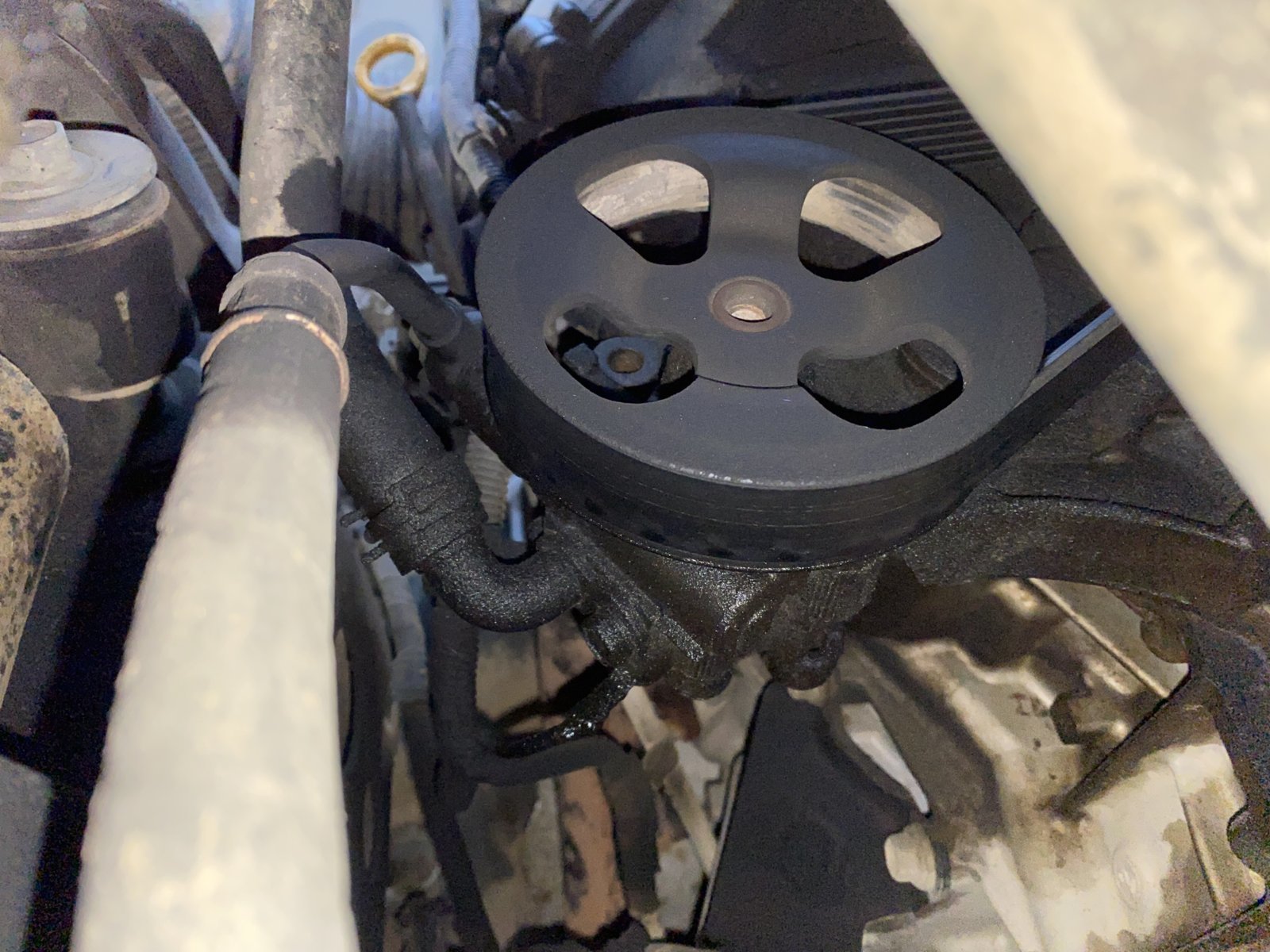

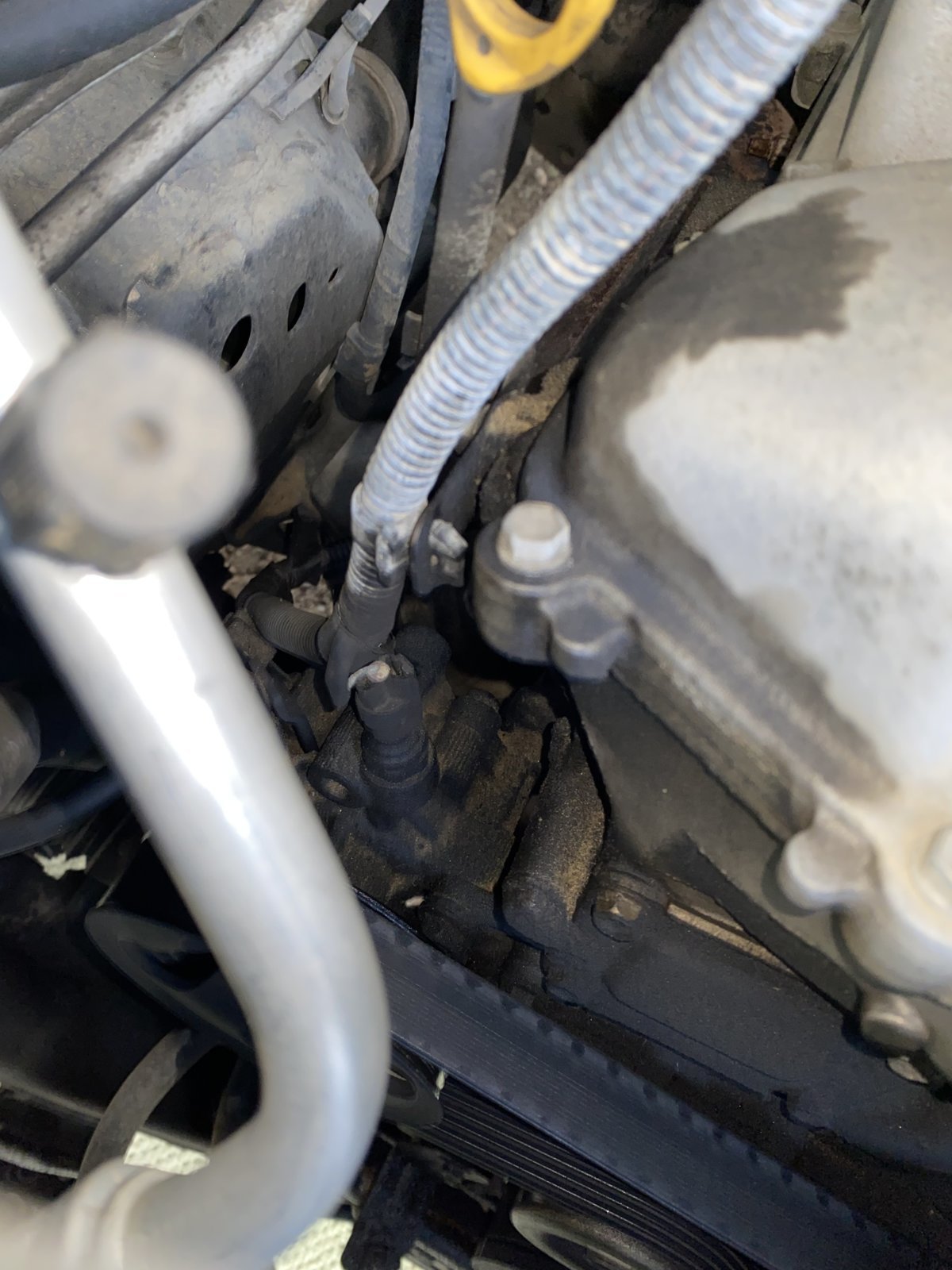

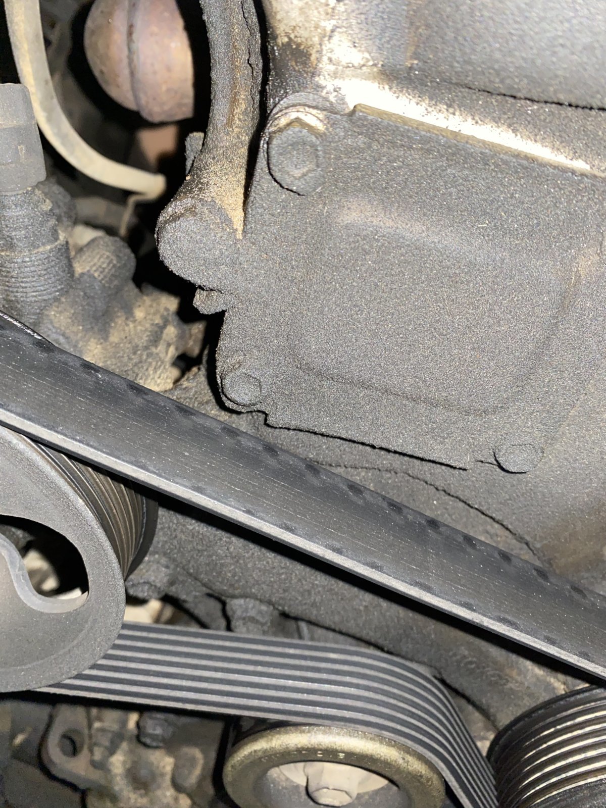

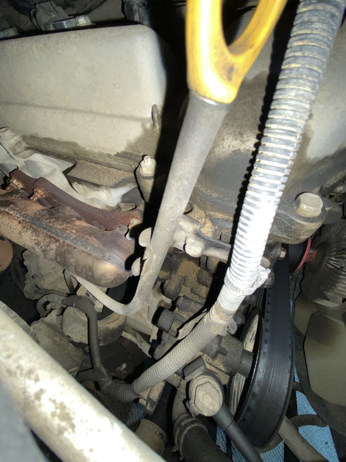

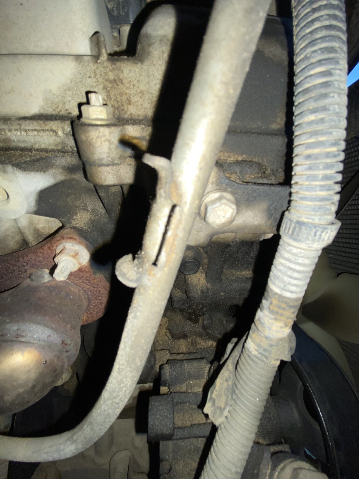

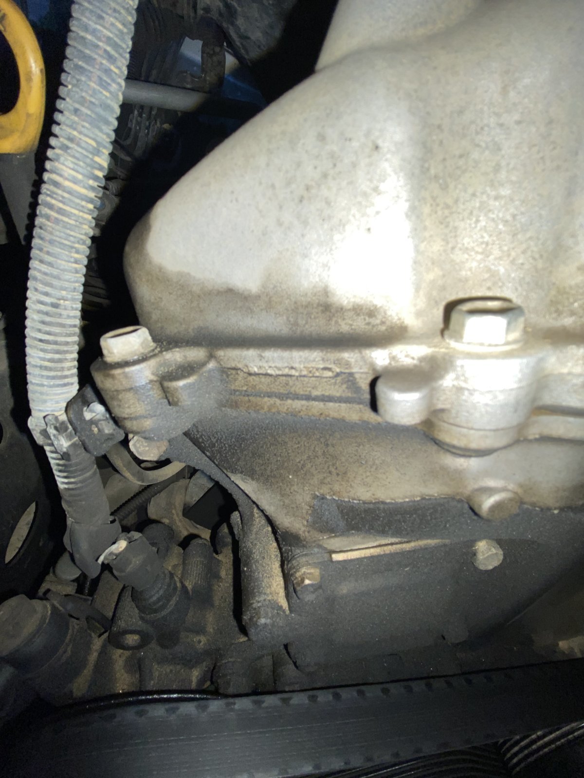

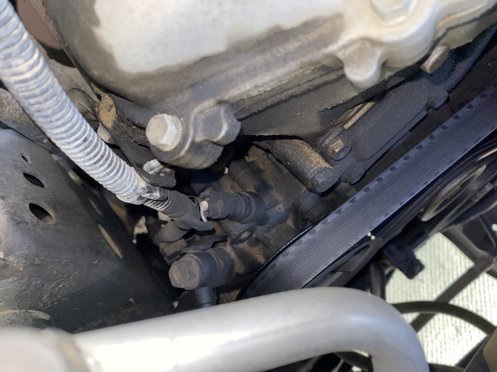

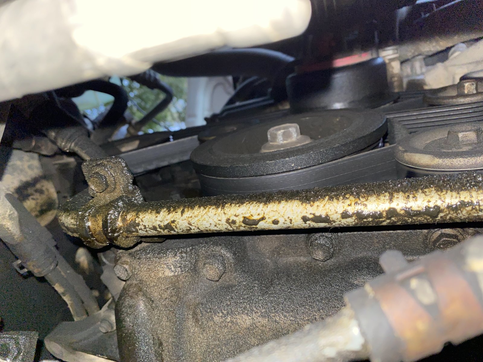

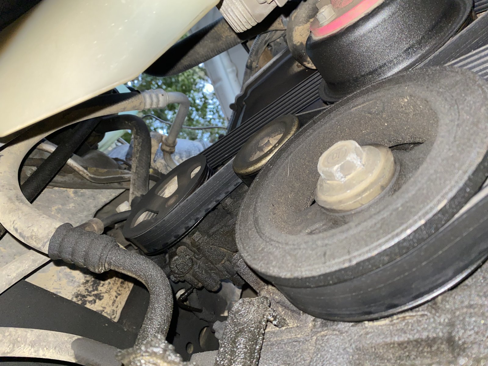

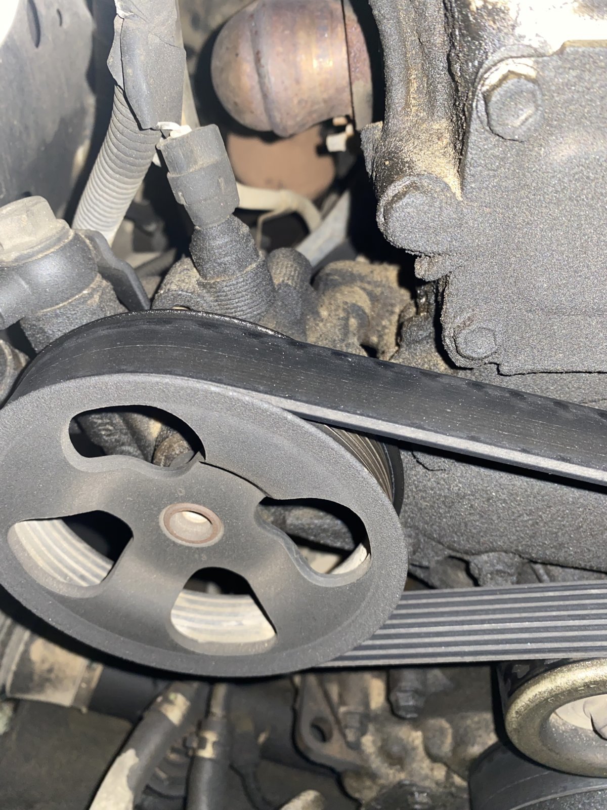

    Hey y’all, I’ve recently been getting a squeal from the front of my engine and I suspected it to be a bad pulley or something. While I was trying to diagnosis that I stumbled upon a bit of oil/fluid on the front side of my engine again and was hoping you guys might be able to help and give insight based on your past repairs. My best guess is that it’s coming from the power steering pump or the small timing chain cover right above it(I would prefer this since it’s a cheaper and easier fix). My truck has also had a humming noise for sometime that happens inconsistently, maybe that is connected. I will upload a video of that noise as well as pictures of my engine. I tried to get as many angles of the area as I could. It’s also possible the squeal(separate bad belt or pulley sound) I’ve been hearing could just be caused by the oil/fluid on the pulleys and belt…

    Timing chain cover is most likely.
    What I would do requires a new belt.
    Degrease the engine and wash it super clean (at a car wash quickly they dont like this lol). This will 100% screw up the current belt. It needs to be changed after it dries.
    Then monitor the leak and its origin.

    The way it looks like the belt and fan are slinging it around I wonder if it isn't the front crank seal leaking.

    timing cover and PS pump? Maybe.
    Valve covers? Looks like it. You can do VCG’s, clean, and re evaluate. Or throw more parts at it you want.
    idk how involved the timing cover job is.
    other cars I’ve had generally have the pump go bad around 10/100 and I put a new one. I don’t act like my truck is somehow any different, made of gold, and refuse to do any work on it. But everyone is different.
    PS pump is supposedly rebuildable. If mine was confirmed leaking I would not be vehemently against putting a new one or rebuilding it. Rather than play the Russian roulette of how many miles can I get away with before it breaks at the worst time like on a desolate trail.
    also, the PS hoses tend to dry up, their connection seal is no longer sealing, and that leaks too.
    id imagine that square cover is just an inspection port that can be taken off, cleaned, and resealed. Rather than the whole entire front timing cover.

    Lot of long term residue makes internet diagnostics difficult. My $is on a leaking valve cover gasket.

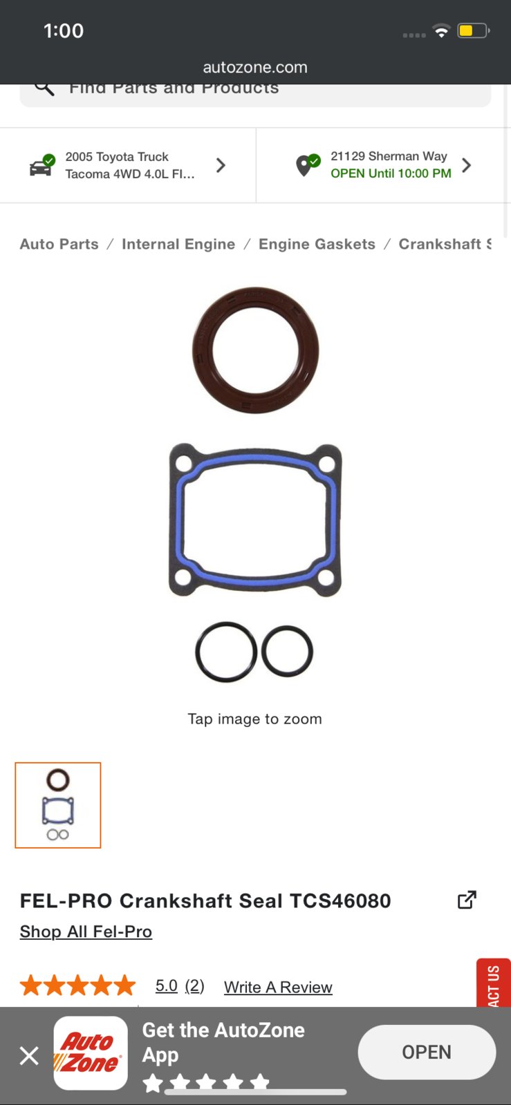

    2005 Tacoma V6 4.0 L 4x4
