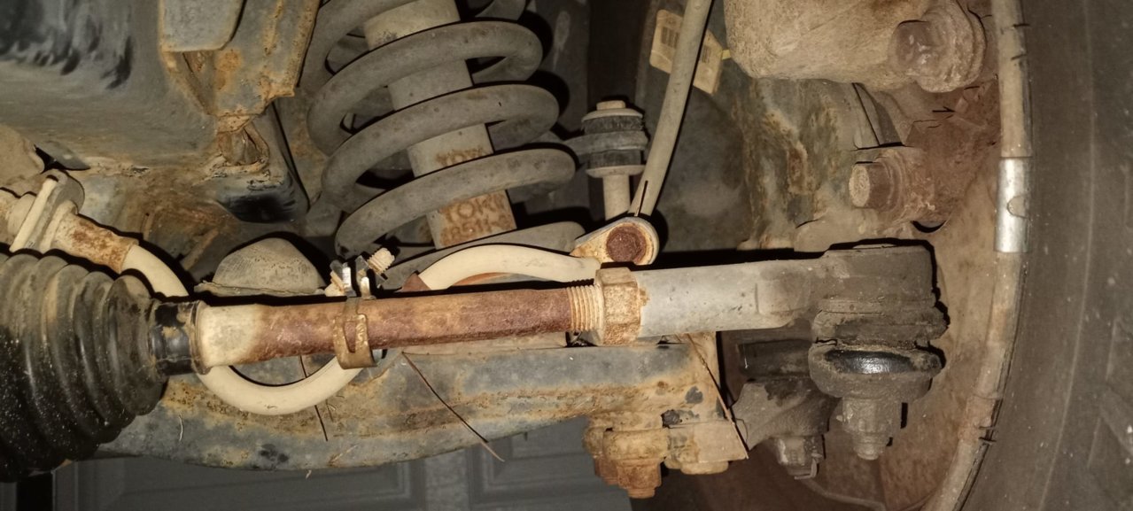

    Here's an image from the ugly underbelly of my ride:
  4. Mar 1, 2023 at 10:54 AM
    turbodb
    turbodb AdventureTaco
    Feb 9, 2016
    #177696
    8,551
    Dan
    PNW
    2000 Tacoma Xcab 4x4 SR5 V6 TRD
    AdventureTaco
    Did you post a question about this to my web site? (I replied there, if you did :))
    At any rate, if 44250-04010 is the right part number based on you VIN - at a reputable dealer as @Red_Taco33 mentioned - then getting a remanned one from Toyota (44250-04010-84 for the remanned part) will essentially be like getting a new one, I wouldn't worry at all.
    Buying remanned somewhere else, or a 3rd party/aftermarket rack, I'd stay away from. At least, that's the guidance for the 4WD/Prerunner racks.

  5. Mar 1, 2023 at 12:11 PM
    Mavigogun
    Mavigogun [OP] Well-Known Member
    Dec 20, 2020
    #350273
    74
    1998 Tacoma X-Cab SR 5 2.4L L4 SOHC 16V
    I did! Thanks much for replying here, as well. As you indicated, the OEM Toyota parts dealer proffered the 44250-04010-84 re-manufactured part. Your vote of confidence is comforting, much thanks- and, of course, for the lengthy how-to that must have taken a good many hours to author.
