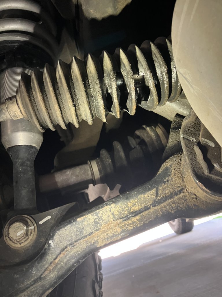

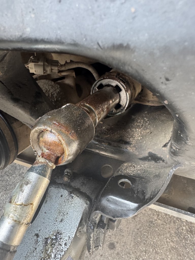

    Just doing my usual greasing and fluid top ups. Noticed that my pass steering rack boot is torn.
    What would you guys recommend I do?
    Replace the boot both sides or new rack?
    RHHousehold likes this.

    Needs a rack, its leaking. The boot rips because it gets soaked with fluid from inside. There shouldnt be any fluid inside the boot ..

    This right here, though boot rips are typically just an age thing made worse by the fluid in this case. The boot exists to keep dust and debris out and if there's fluid, it's blowing past the seals in the rack. You can do a boot pretty easily as a temporary fix but ultimately you need a rack sooner than later.

    Do you want to fix the symptom (torn boot) or the real problem (leaking / worn out rack)?

    Thanks all, there is nothing wrong with the rack other than it leaking a bit.
