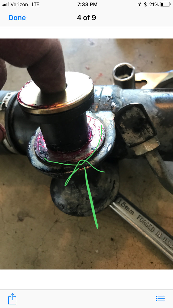

    Trying to replace the rack and pinion bushings on a 2015 tacoma. Can’t for the life of me get the new bushings in. Any tip or suggestions?
    **Figured it out. Did not realize this was the outter portion of the original bushing. What I outlined in green is the original bushing. I though it was part of the housing. Hopefully this helps someone in the future. As you can see I could not get the bushing to fit with the outter sleeve still in!E8D720B8-FFDC-4D81-BAF3-07A404D6F8E9.jpg
