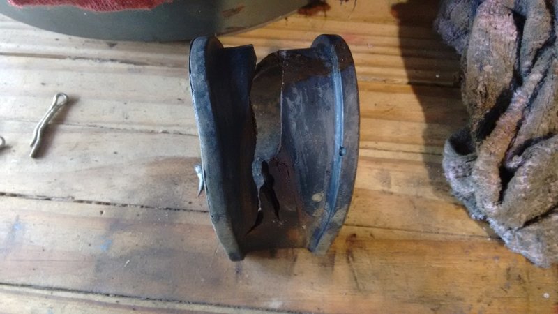

    Here's an update. I finally got around to replacing that Energy Suspension wrap-around bushing. It was getting pretty bad.
    When I pulled it off it looked like this...
    I replaced it with an $8 AC Delco bushing which I think was still poly instead of rubber, so we'll see how it holds up. I'm not expecting much for $8, but maybe I'll be surprised.
    Edit: now that I have another bushing, I'll probably warranty the ES bushing since it has a lifetime warranty on it. Then I'll have a spare.
    It's also worth noting that the bushing on the left side with the through bolt looked fine.
