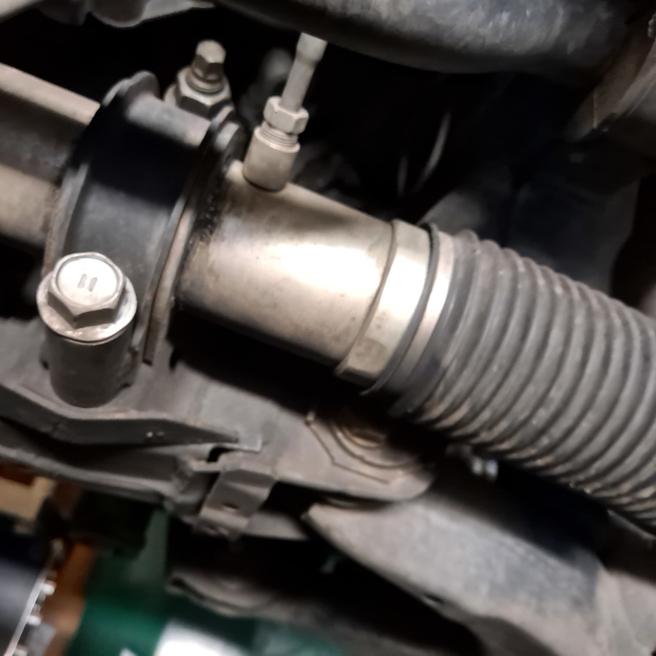

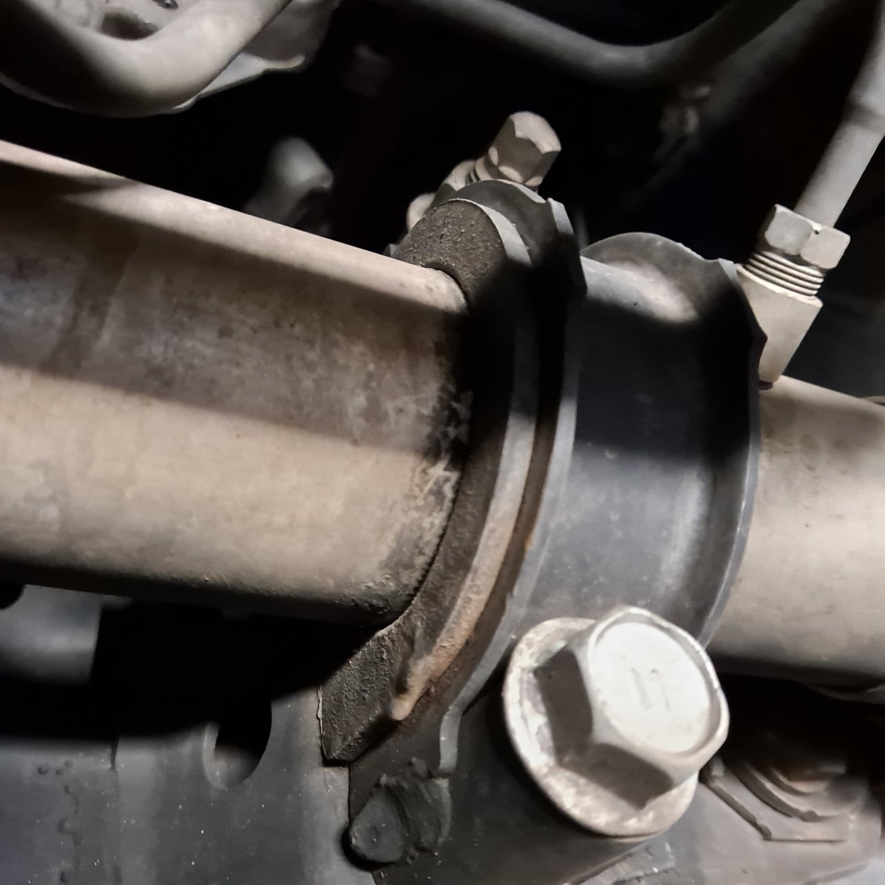

    is it normal to have rubber residue on either sides of this clamp bushing?
    The rack and bushings were all replaced 4 years ago OEM?
    Does this part of the rack actually move to make rubber marks on either side?
    I have rubber residue on both sides on the rack from the clamp bushing and my alignment seems to get out of wack every 15,000 miles

    Probably time for new rack bushings, I assume you've done them once or twice already in 600k+ miles?
    If the rack moves at all when you crank the steering wheel left/right, it's time for new bushings. You can kind of look under the truck while turning the wheel, or have a friend turn it while you look under.
    On mine, I could see the rack physically moving side to side. Doesn't move anymore with new rack bushings (there are 3 total)'
    edit - missed the part about them being replaced 4 years ago, I would say it seems a little early for new ones again but you do put considerable miles on them it sounds like. Look at the rack while someone cranks the steering wheel side to side and you'll know if you need new ones.
    Maybe try poly bushings this time?

    No, it shouldn't move.
    I say go for the ES poly bushings.
    And get your kid with his tiny fingers to install them.

    Residue is probably from the rack moving in some way. Definitely recommend the energy suspension polyurethane bushings. Now for your alignment, I can't say. bushings should only change the play in the steering. Its possible something is loose and moves a bit all the time?

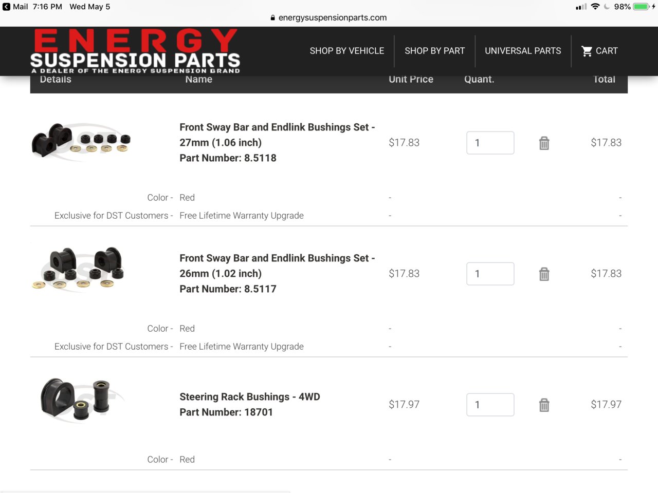

    Yup,
    New polyurethane bushings are on my list,
    My AC compressor just burnt up, so that’s 1st and then ordering the bushing kit.

    At least the bushing kit is inexpensive, something like $25. Lots worse out there.

    Which end links do I need for the 1997?
    There are two different part numbers, different sizes?

    I think your existing bushings will have the size stamped in them.
