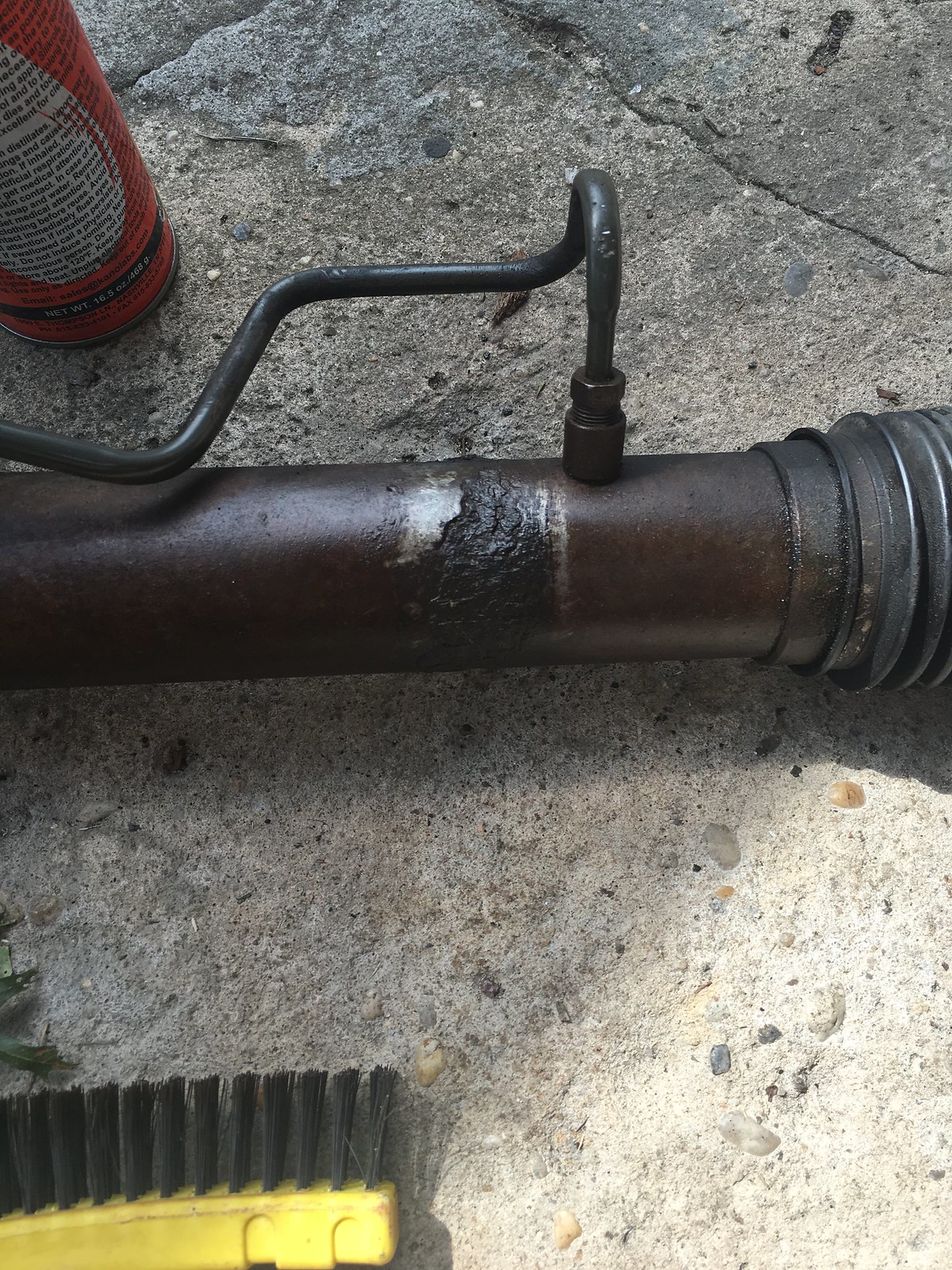

    Went to turn into my driveway the other night and found the steering acting funny. Got out, heard the power steering pump howling a bit and saw the fluid leaking from underneath. Great.
    Ordered parts - It has 144K Miles on it so I ordered a new rack with inner and outer tie rod ends and a new D mounting bushing.
    Got the armor off and found it leaking by the D bushing. Stripped it down some more and still couldn't see a crack or leaking fitting or seal. Added power steering fluid (ATF) and saw it weeping out.
    [​IMG]Untitled by Doug Hansen, on Flickr
    Got the rack out and on the ground and still nothing obvious except the corrosion. Must have become porous. I live on Long Island in New York and I guess the road salt got trapped behind there. The frame's been through the recall and passed and I don't have other corrosion related issues. Just this one spot.

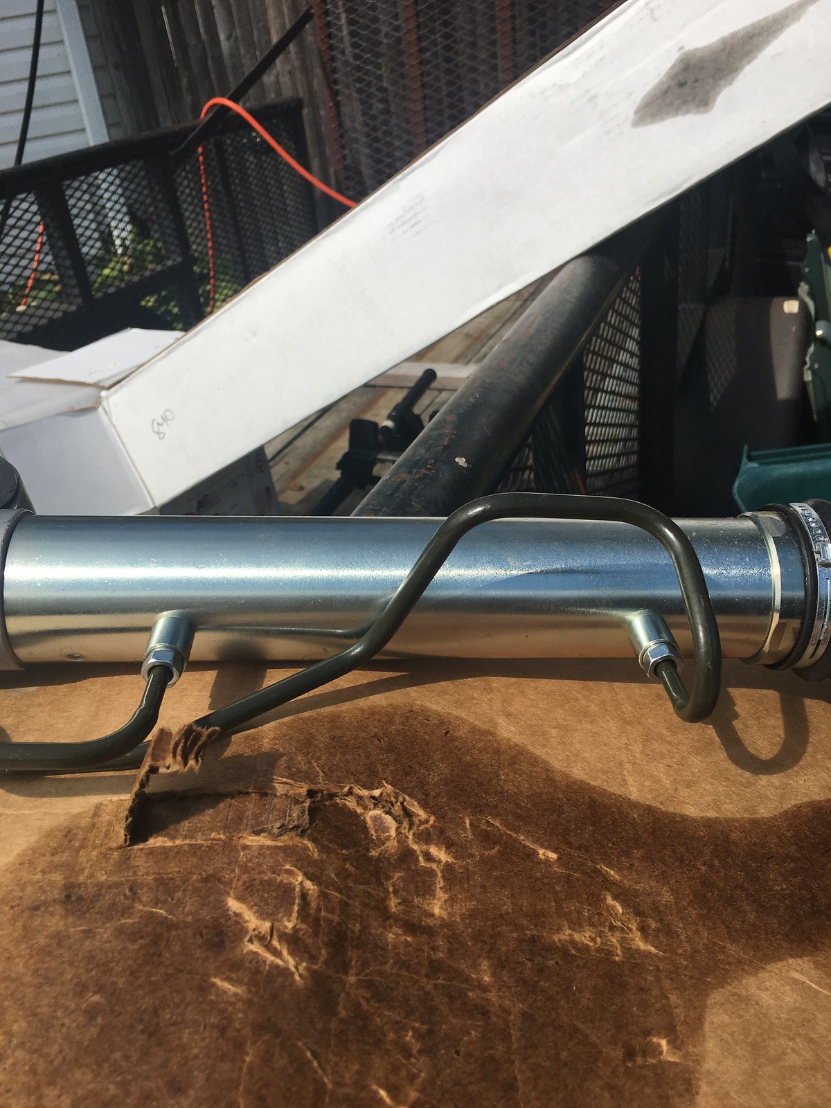

    New shiny rack:
    Can't say I'm thrilled to be doing this but I can't blame Toyota for it either.

    Looks like bushings were bad and it was rubbing back and forth.

    Bushings were OK, just rusted out under the D bushing. There also were raised rust bubbles under there. I was tapping, scraping and wire brushing on the spot. I was so confused that I didn't see a bad seal, fitting or even a crack. I wasn't sure why it leaked all the fluid out inside of three minutes. I immediately ordered a rack and I'm glad I"m not returning it. I hate returning stuff.
