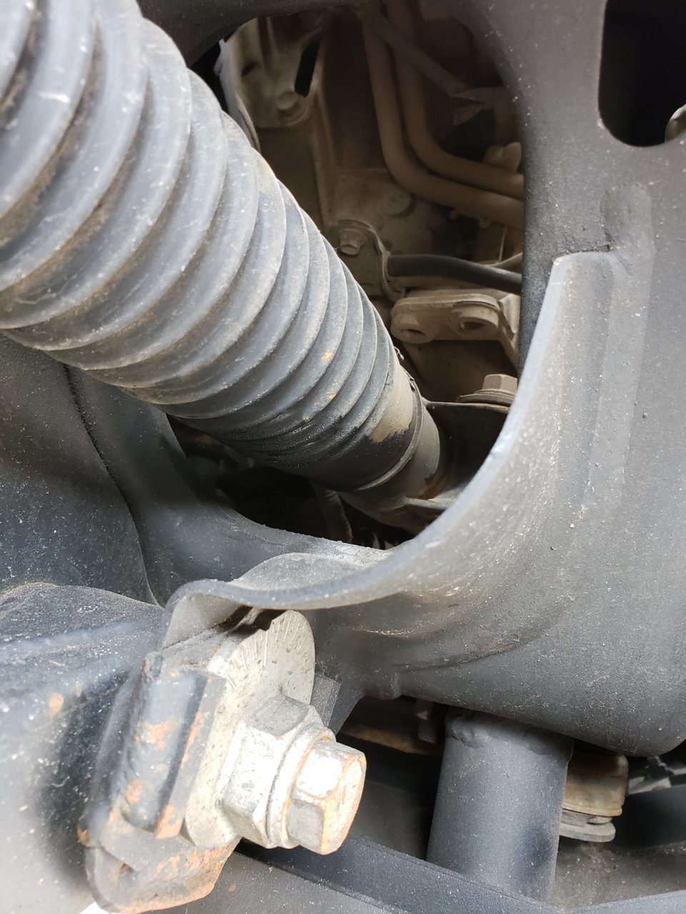

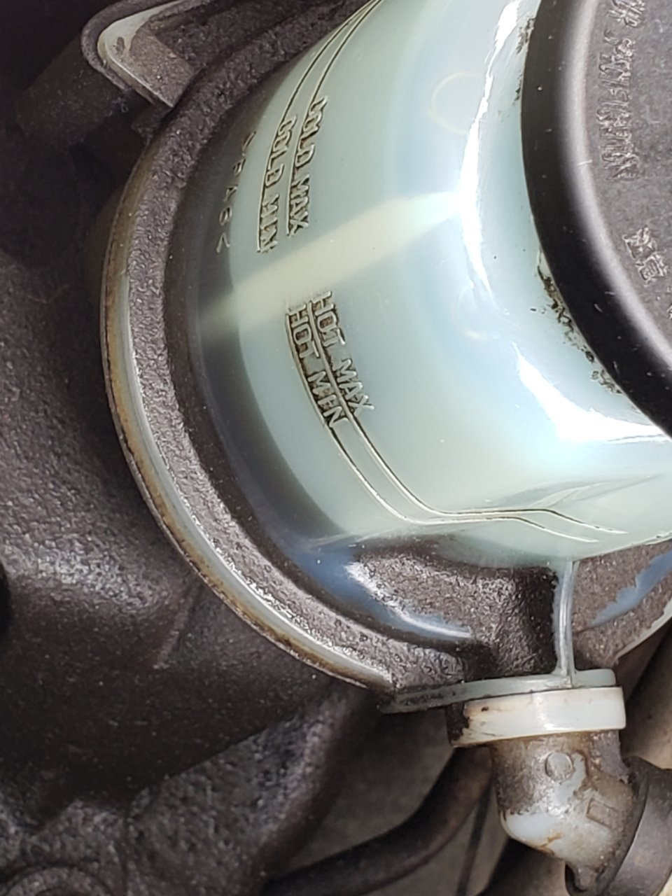

    Was cleaning the truck today and just wiping down the engine bay a little and noticed the power steering fluid was low so started looking around.
    Passenger side is wet with oil so seems like it's leaking from here. Driver side is dry
    Already know it won't be warrantied since around 58k I was at the dealer because I had a clunk from my inner tie rod which they said is only replaced with the rack and they won't warranty it because of the 2"lift and 33s.
    Not sure what to do now. Get a reman or try and upgrade to something stronger. Problem is only thing stronger is the tundra swap from solo Motorsports which is easily going to cost me $3500+ by the time all the fab work and shipping to get it here in Canada.

    How come your reservoir is so dirty? From toping it off?

    a brand new one from rockauto is 336 for here in the US....

    Haven't topped it off.
    It's just a dirty engine bay. Oil spray annually doesn't help

    Ya but labor is a bitch. Need to drop diff according to Toyota

    It’s not hard to do yourself. Just time consuming. Get a couple buddies and some beer and bang it out.

    Ahhh oil spray. I thought the reservoir was leaking.

    My steeeing rack died at 22,000 miles. Leak on the driver's side. Luckily mine was replaced under warranty.

    Just curious about a couple things...not implying anything.
    Did you do zero point calibration after lift and alignment?
    Do you go to full lock a lot?

    Lol that is extremely minor, hardly low in the reservoir and and the spot that’s “wet” looks like light seepage. I would live with it for now until it starts actually leaking to a point it should be replaced
