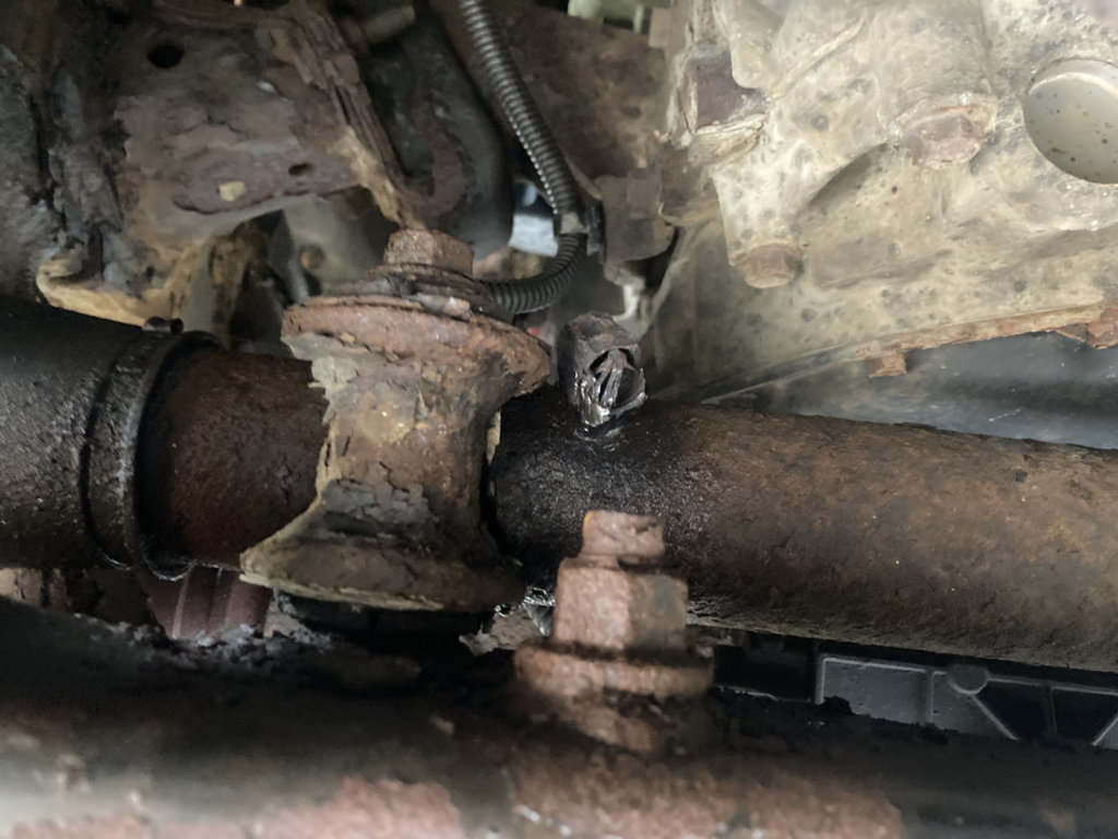

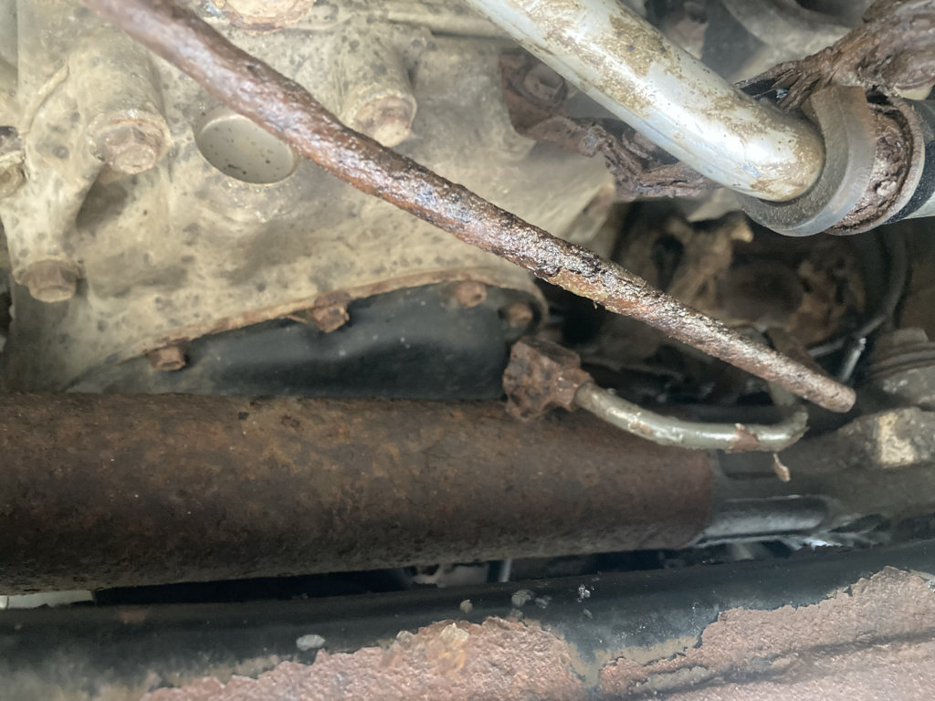

    Does any one know if the rack transfer line fittings are removable or am I looking at a rack replacement? Had a second power steering leak the other day, first was the return line to the pump and now the rack ones are toast. I managed to get the line removed but in doing so the fitting did not survive. 2009 2.7L living in rust hell at the moment.

    That rack is toast sorry to say, I've never seen the rack transfer lines available and even if they were it would very likely leak from that fitting.

    Thanks for the quick reply, I was afraid this was the case, I'll start shopping for a rebuilt one, anyone have a suggestion for a good Canadian friendly source?
