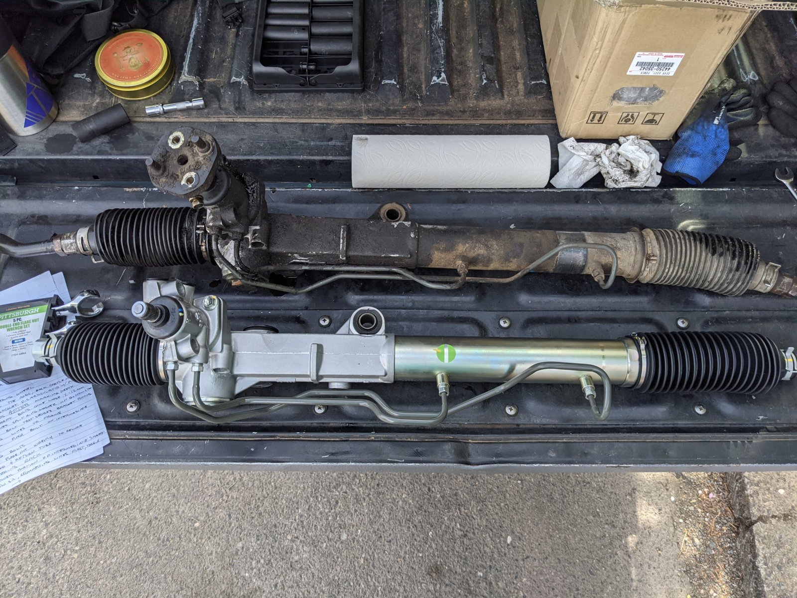

    Yeah, I put the 44250-35042 on my truck (1995.5 4x4) 3 years ago with absolutely no issues since. Here's a quick and dirty photo I took when I swapped them. The steering rack should fit your 1995.5 SR5 and it will be cheaper than the remanded version by at least a few six packs' worth of beers. I would return the remanned version and get yourself the 35042. Lmk if you have any other questions about it.
    Jagernats[OP] and turbodb like this.

    It's less Tacoma and more mod
    Center vertical bushing sleeve ID size.
    Bend_corners likes this.

    I was wondering if that's all it was. I thought that change was made between '00 and '01 though. If it is just the bushing, then using 44250-35042 for '95.5s seems like an easy/right thing to do in order to stick OEM.
    Jagernats[OP] likes this.

    They change the rack guide bushing too but it makes no difference to an early model.
    turbodb[QUOTED] likes this.
