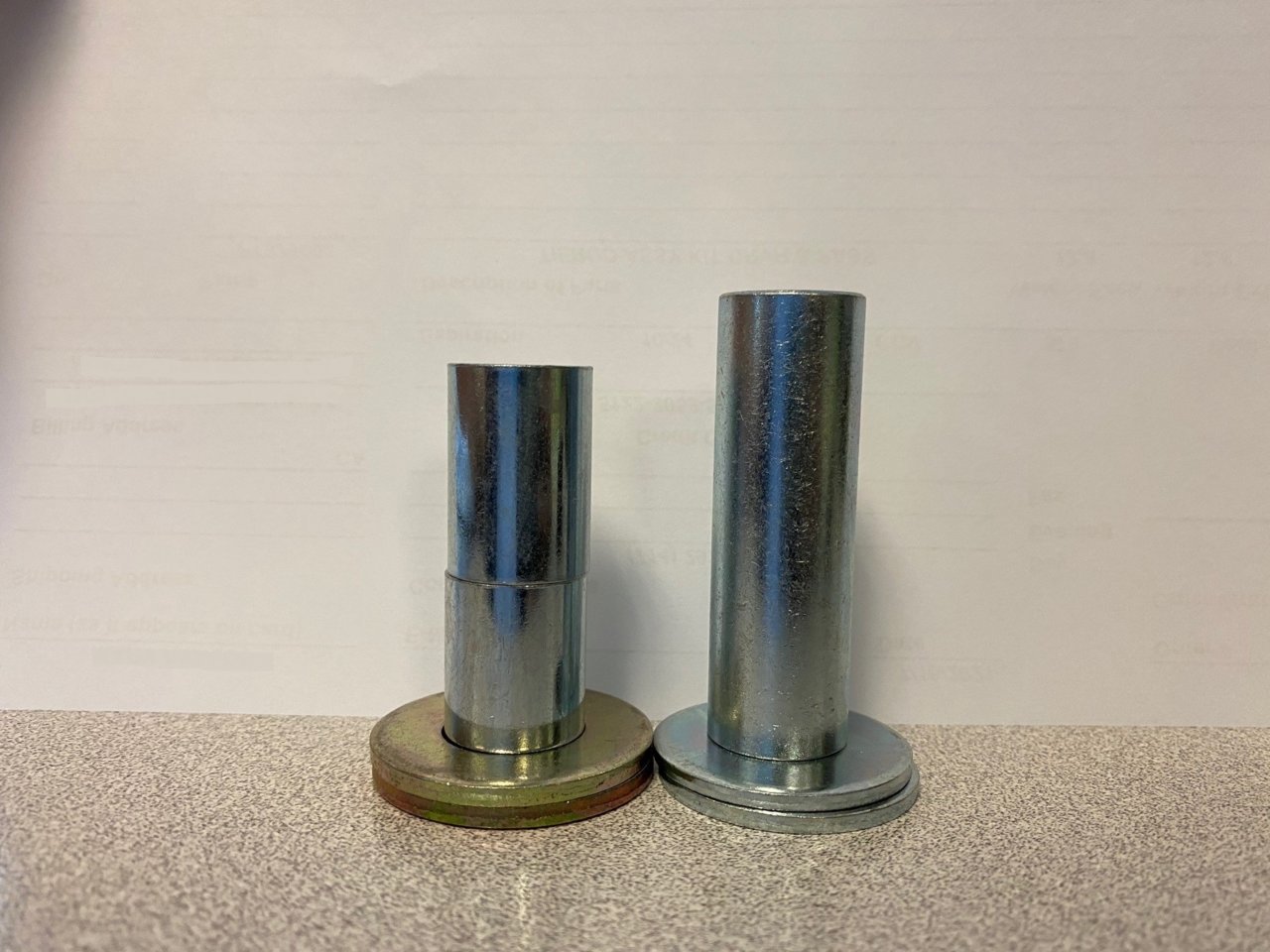

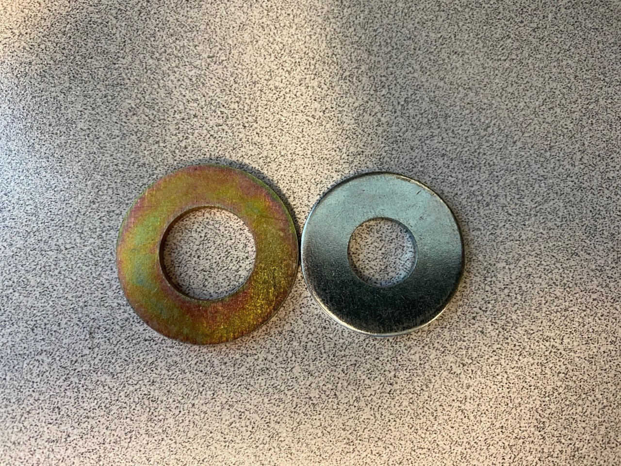

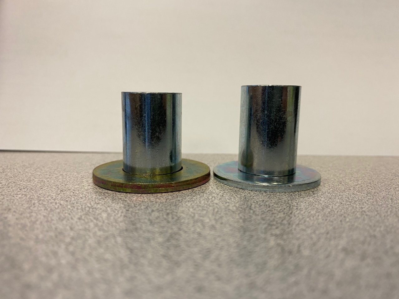

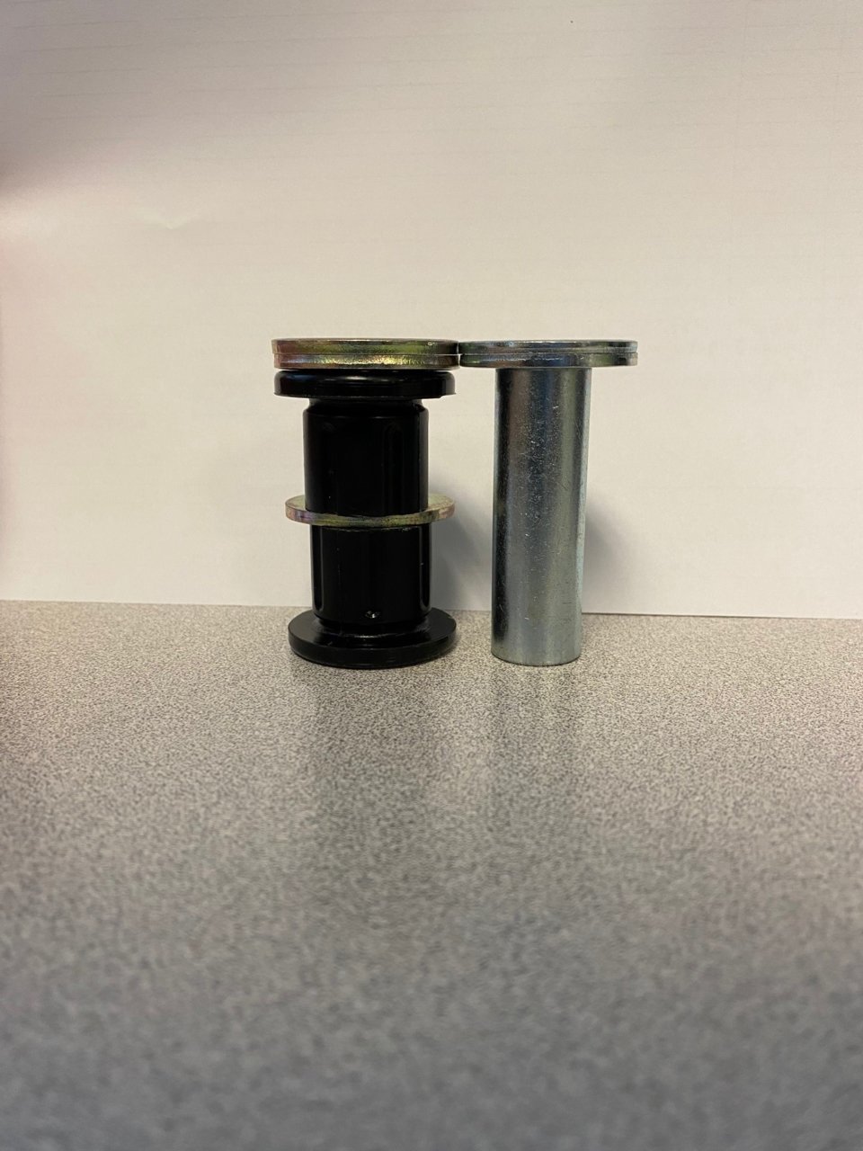

    I'm not going the route of getting a larger bolt anymore, but instead following what @Sandman614 did. Larger sleeve and a set of washers that do not drop into the sleeve itself.
    The first issue with the whiteline kit is that the sleeve itself drops into the hole in the washer, as this reduces the overall length. Secondly, they give you two half sleeves and not a full length sleeve. The 3mm gap that is supposed to be there is gone once the bolt is fully torqued to spec. This makes the overall length even shorter! So, you end up tearing the bushing lip/flanges right apart after you install the original design and hope you line up the washers to drop into the sleeve.
    Whiteline on the left, my new setup on the right.
    Flawed washer design on left
    Whiteline sleeve dropping into washer on left vs sitting on top like it should.
    Overall length as it would be when fully torqued down and installed. The left whiteline side is missing the 3mm gap in the center that should be there, but isn't because it is not a solid full length sleeve. It is also missing height because the sleeves are dropping into the washers.
