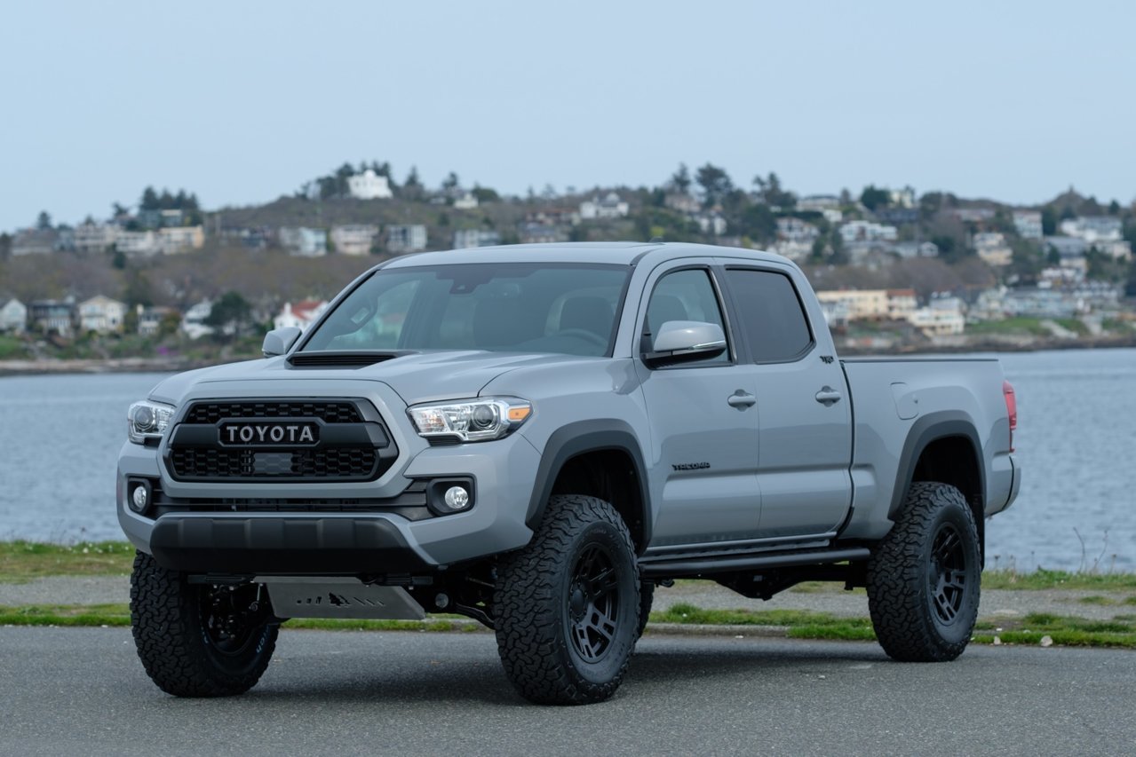

    Hey all, I’ve got a 2018 Tacoma that’s lifted approximately 2.75 inches with 285/70R17 tires. The truck has just under 22,000KMs (Roughly 13,700 miles). I recently noticed that the drivers side steering rack boot looked wet. I took the truck into the dealer who confirmed that the steering rack was leaking and denied warrantying the part due to the lift and want $2400 CAD ($1700USD) to replace the rack.
    How common is this with lifted Tacomas? This is my first lifted vehicle so maybe this kind of stuff just comes with the territory. Do you think this was a one off occurrence or could I potentially end up going through steering racks every few years?
    Picture of my truck below!
    Thanks all!

    I would say it had more to do with the tires than the lift.

    Yeah that's very possible, I thought 33 inch tires were a safe bet and 35 inch tires are where issues start occurring.

    I'd try a different dealer if I were you. What region are you in? I see water so I cant help you.

    Yeah for sure, the dealer that denied the warranty also sells brand new Tacomas with lifts and 285 tires so it is kind of frustrating.
    No spacer, bilstein 5100's.
