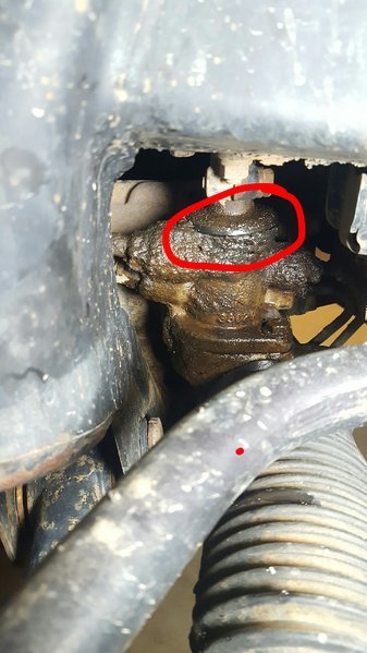

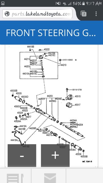

    Iv got a leak from the top of my rack. Can anyone tell me a part number for this seal in my picture. As far as I can tell it is part number 45222.tmp_7619-Snapchat-1930664740531349261.jpg tmp_7619-Screenshot_20170301-091757871550038.jpg Any advice on fixing this would be appreciated.

    First off that diagram is for a 2wd 5 lug rack you want 4wd. Determine if it is the upper control valve seal or a line that is leaking.
    2nd, it would be wise to do at least a partial tear down first and inspect for rust and/or damage to internal parts.
    3rd, you would want to get a seal "kit" with all the seals and o-rings, aftermarket is fine.
    4th, that seal is the single most difficult part to replace in the entire rack, and there is a fair chance that the bearing just under that seal will be damaged in removal and need to be replaced.
    5th, an OE 96 rack should have other internal parts upgraded, known as the driver side "rack guide". This plus given the age other wear may render it not worth the time or money.
    What you are getting into, here.
