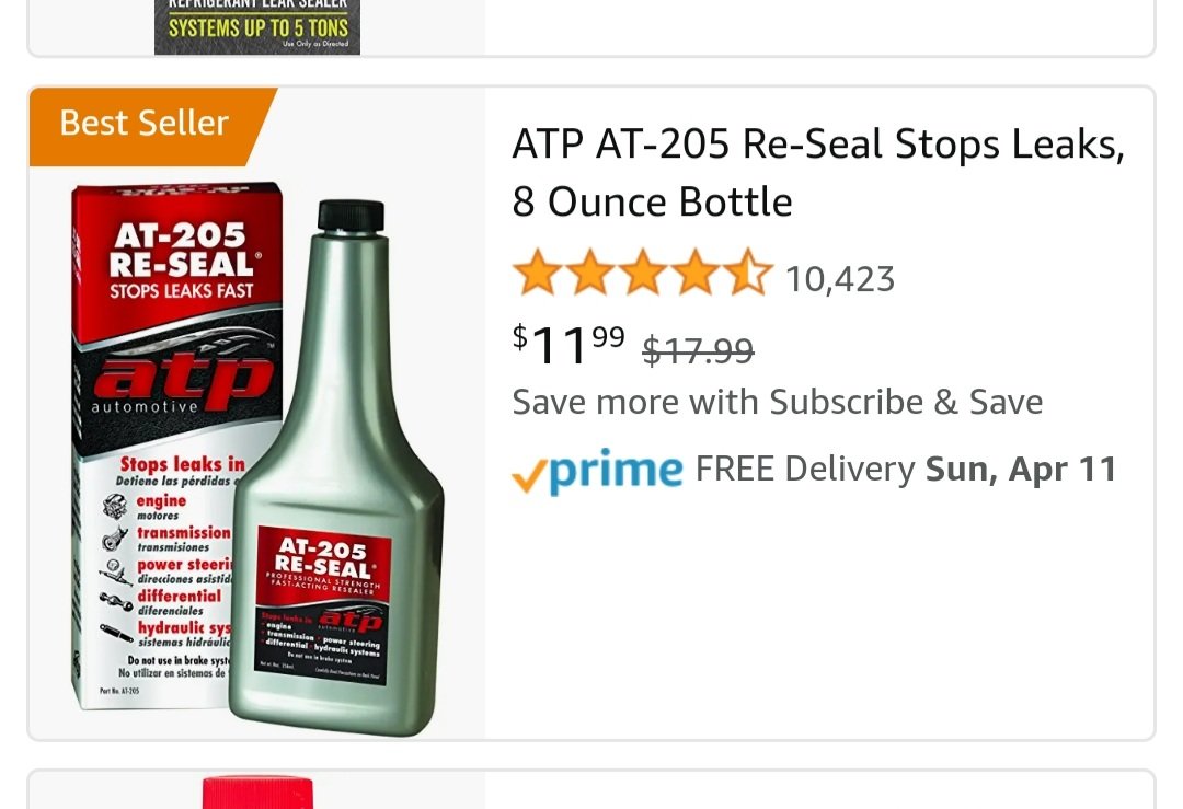

    Not sure how much it's leaking but I have a 1995 Integra that had a small leak in the steering rack.
    I flushed the system then put in new PS fluid and a few ounces of AT205. It's a polymer sealant that works well for me. It took a couple of days to seal but my garage floor is now dry.
    It's worth a try...can potentially save a lot of work.
    Edit: Also pay attention to Whatstcp's post above.
