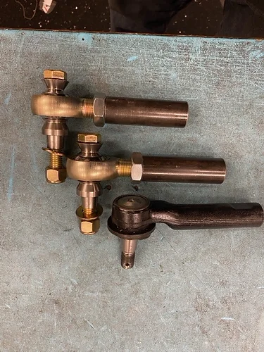

    Just got my truck back from the shop after a steering rack replacement. They told me the reason the rack and inner tie rods keep failing is that at full droop the inner tie rod is binding and placing additional force on the rack and seals. That mostly makes sense to me but in all my countless hours of research I've never heard of this happening and there are countless others who have the exact setup as me. Any of you had to deal with this? How did you overcome it?
    I'm a little worried cause I'm heading out to canyonlands for thanksgiving and I really don't want to break something 100 miles from civilization.
    My mechanic recommended trying these (link) heim joint outer tie rods that have more articulation, but that doesn't make sense because that would put the outer tie rod end even more at an angle. Would possible work if the taper was the opposite direction, but I think that would cause some bumpsteer.
    Or, is my mechanic just wrong?

    Those should only matter if you have extended or long travel with longer LCAs..
    Not sure how a heim joint in that location would allow much more articulation (1/2" maybe?) than a ball joint - it would just mean your end link ball joint wont leak because its a dry system
