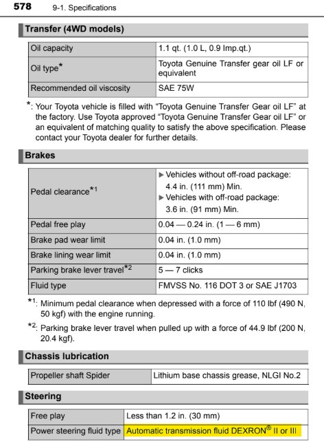

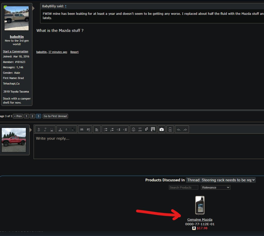

    Hi just want to confirm this is the Mazda transmission fluid on Amazon? Not power steering fluid? Mine 22 TRD started leaking very little at 50,000
  3. May 30, 2025 at 11:08 AM
    #43
    tonered
    tonered bartheloni
    Sep 25, 2017
    #231055
    31,146
    tony
    Lynnwood, WA
    Yessir. The linked Mazda ATF is used in their PS also, which is why I had it on the shelf and topped up my Taco with it. All the same Dexron III spec.
    My boots are still dry at 110k.
