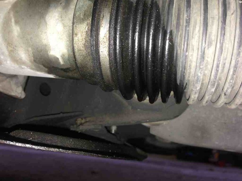

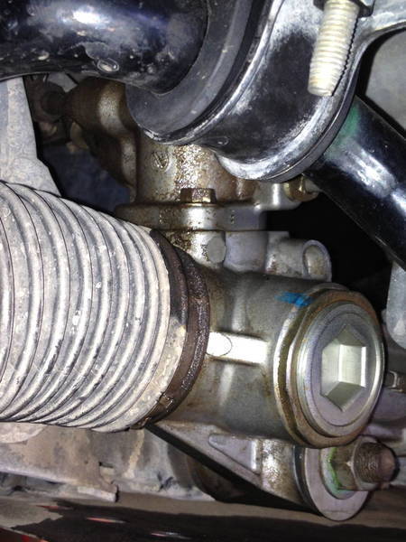

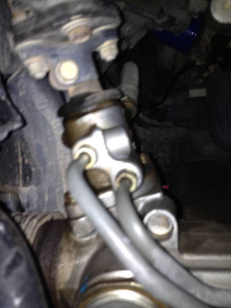

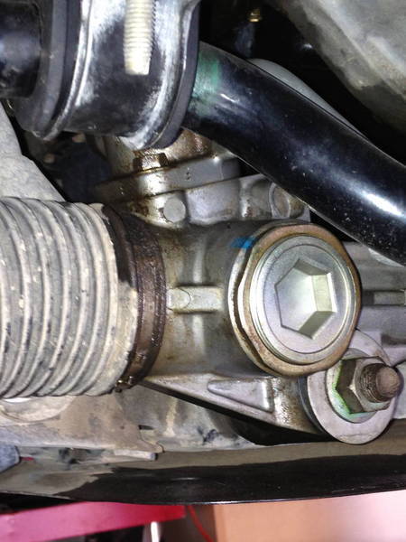

    I was about to take off my sway bar off today and then I noticed that there was oil leaking off the steering rack. And I was thinking that it was the bushings inside were worn out. Here are some picture and tell me what you think the problem is. [​IMG][​IMG][​IMG]

    Power steering fluid leaking from the bellows. Replace rack

    in the first pic...
    it looks like it is leaking from above down onto the bellow
    If the rack's end seals were leaking...
    I'd think only the lower side of the bellow would be wet (oily) !? :notsure:
    I'd pull back the bellow off the itre and check.
    if the bellow is not full of atf/psf then you don't have that issue.
    instead it may be leaking at the seal at the racks input shaft.
    how much fluid was found on the ground ?

    octagon thingy ? Lol
    that is the cap that seals/holds the rack guide in place.
    They can weep a little if they aren't sealed well.
    I've replaced 3 racks... numba 4 still going
    I refuse swap them out until they bleed fully.
    normally I'll kill two pair of itre's before the rack dies
    The PS Resevoir is in the engine compartment
    near front on passenger side.
    well for the 5vz anyways...
    what engine ? (I must'a missed that) :eek:

    is this where the steering shaft goes into? i plan on replacing the bushings on mine
