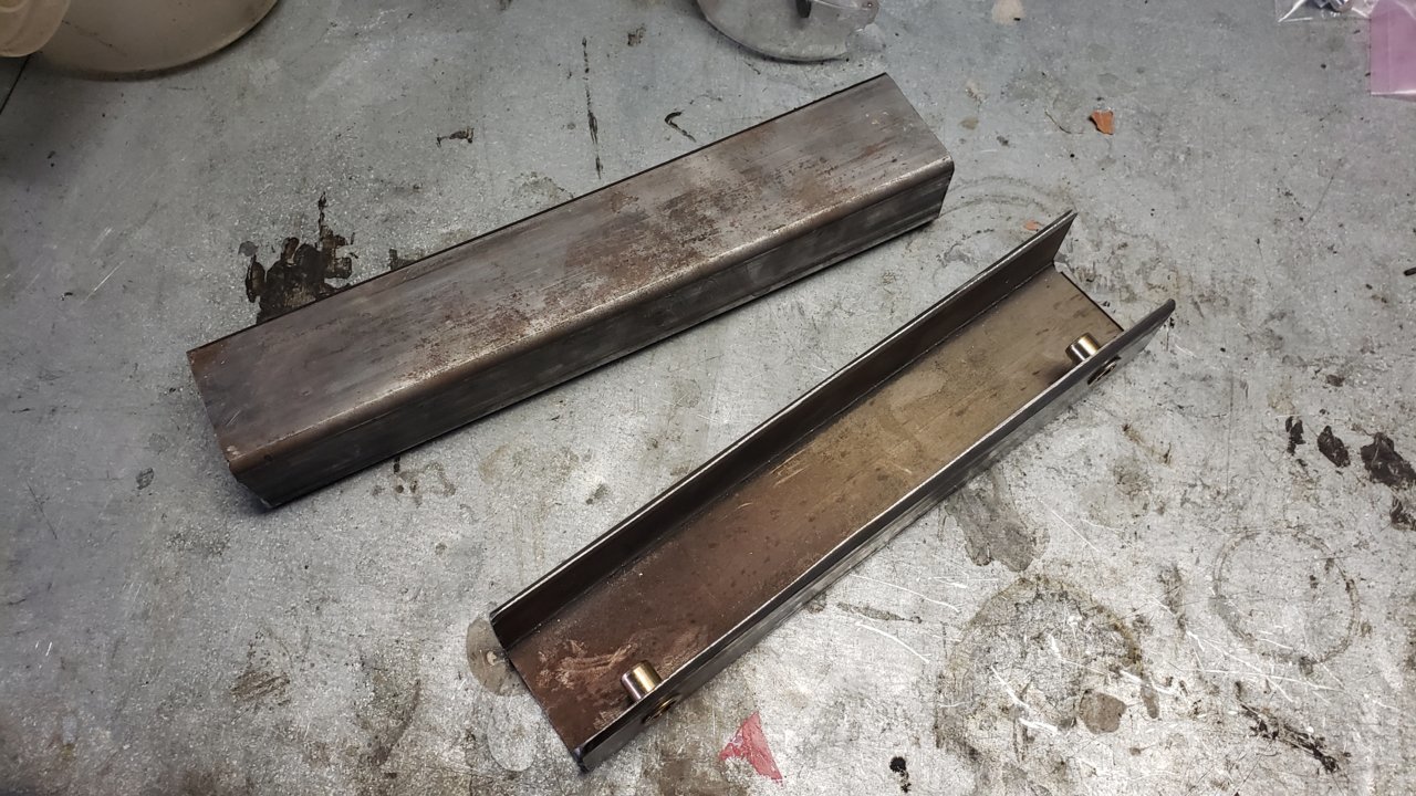

    Just did the rack on my son's 4runner a few weeks ago. I had the same problem. The supply/return lines were BY FAR the biggest pain in the ass for me. Ended up buying a longer flare wrench. Also needed the head of the wrench to swivle a little bit to get a better angle.
    GEARWRENCH 15mm x 17mm Ratcheting Flex Head Flare Nut Wrench - 89105 https://www.amazon.com/dp/B007C6K17M/ref=cm_sw_r_cp_apa_i_GPjlEbKCE31CQ
    And needed to apply even more leverage, so I slid a scrap section of box tubing over the end to make it longer.
    Box tubing like the upper one pictured.
    You'll have to loosen everthing else so your rack will slide back, to provide access from the driver side to the fittings.
