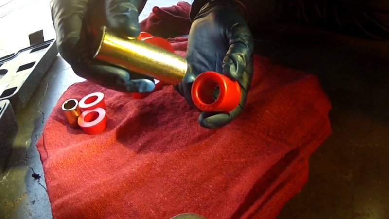

    Just replaced my steering rack bushings and still have rack play when i turn the wheel. Is alittle play in it normal? Everything is torqued correct and i can budge it with my arms.

    I ordered them trough my local 4wheelparts. The modle # on the box was different than what was on the instruction sheet with the bushings inside but 4wheelparts insisted they were the right ones and they put those instructions with every box. All the bushings seemed to fit and are very snug. I had to use a clamp to press them into the rack. I dont get why i still get full rack movement

    Seems like only one side really has play. The passenger side "C" clamp has way more play than the other side. How is that??

    Make sure you installed the c clamp the right way. Check the video around 20:50
    The longer part of the bracket goes on the bottom

    Also, did you put the round medal thing inside of the bushings ?

    Yes i did.
