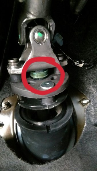

    Bringing back an old thread, but I need help. The Viton bushing on my 14 slipped off and I can't for the life of me get it back on the shaft. Any ideas?!

    Stealership :notsure:

    Yeah, have an appointment this weekend... But dint want to go. They had no idea what I was talking about.
    Said it was because of my lift kit.. Wtf

    Grrrr, nothing to do with your lift!!
