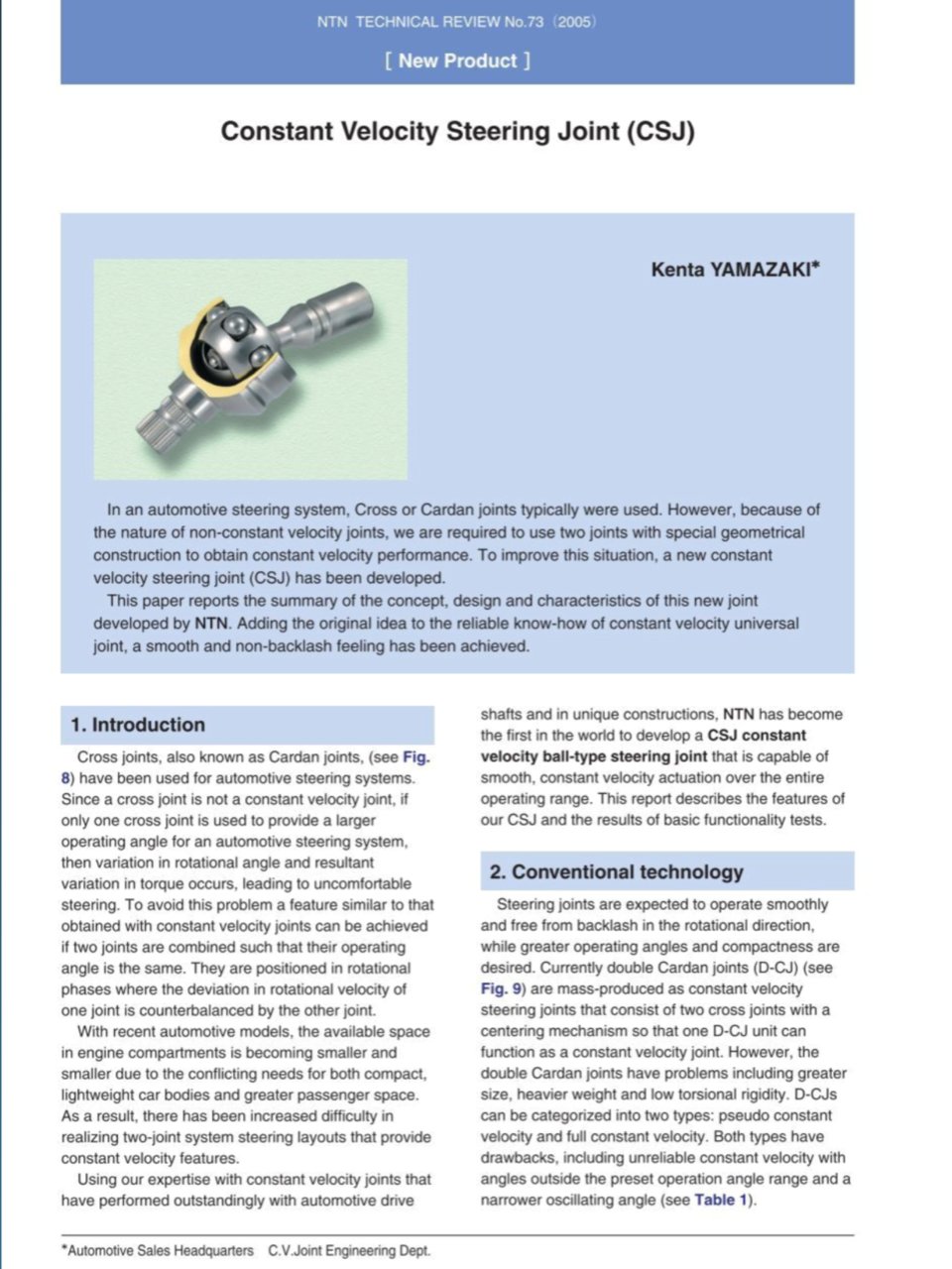

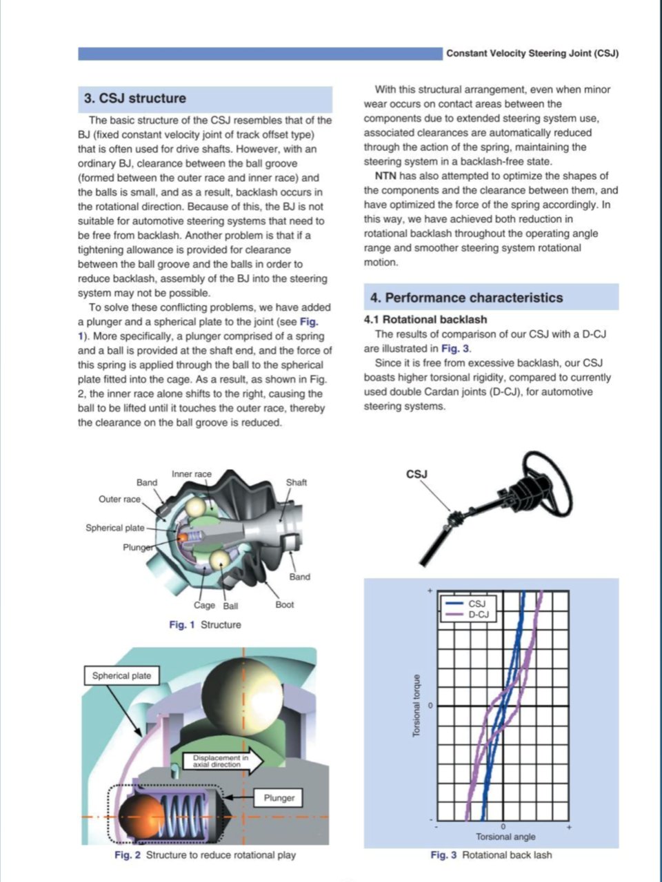

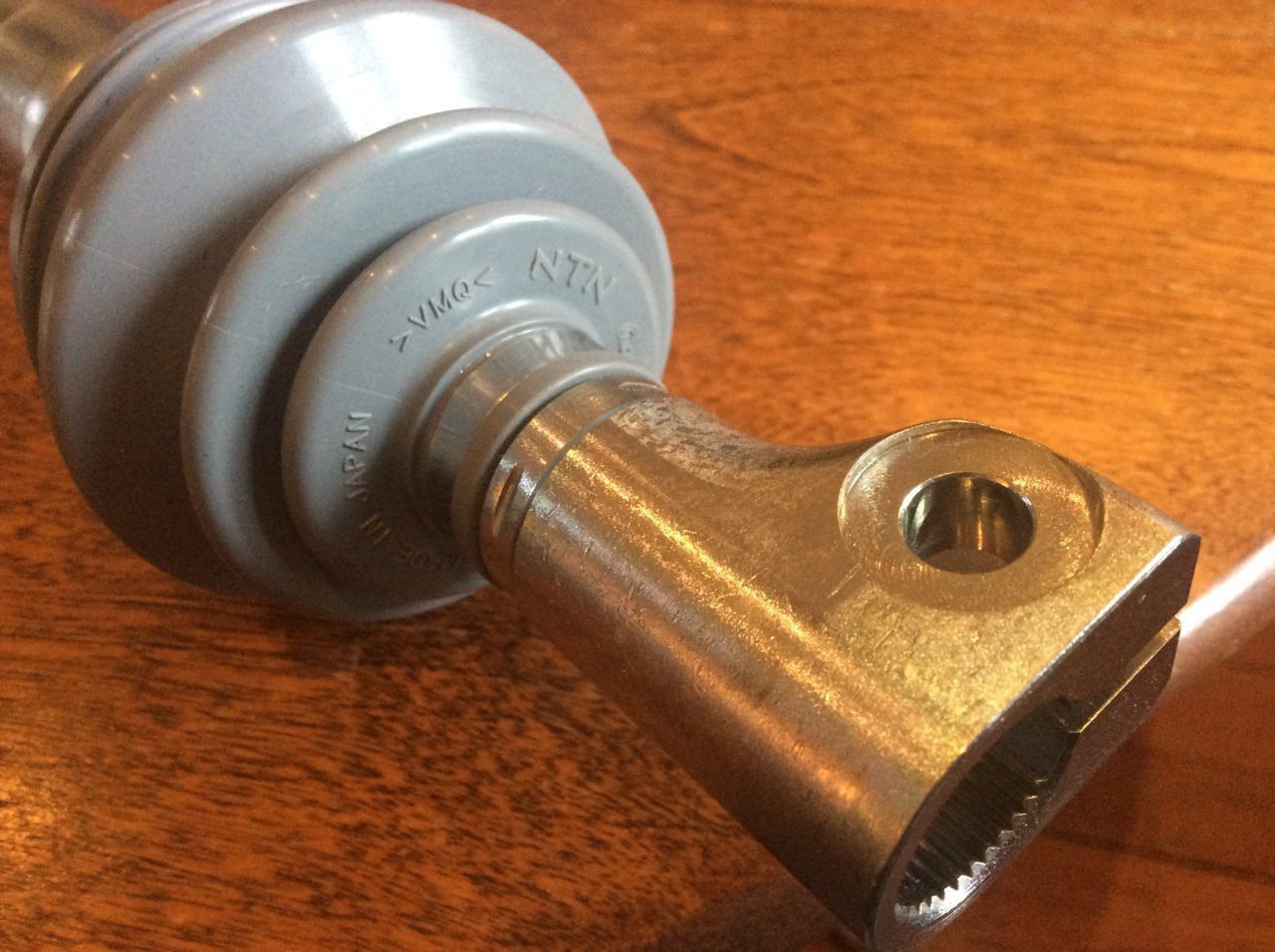

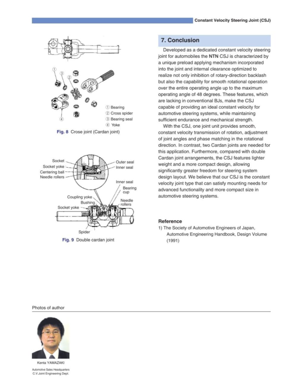

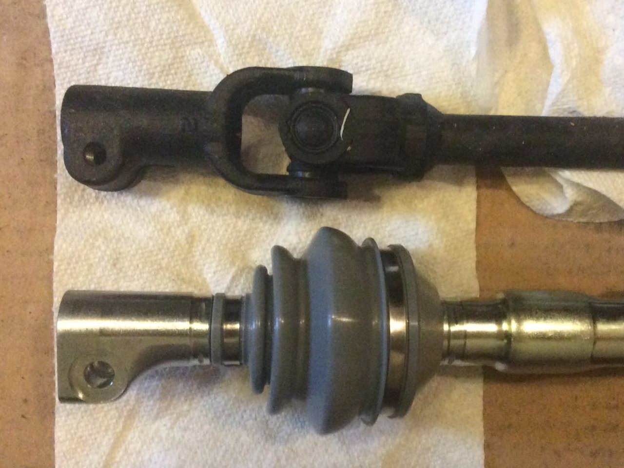

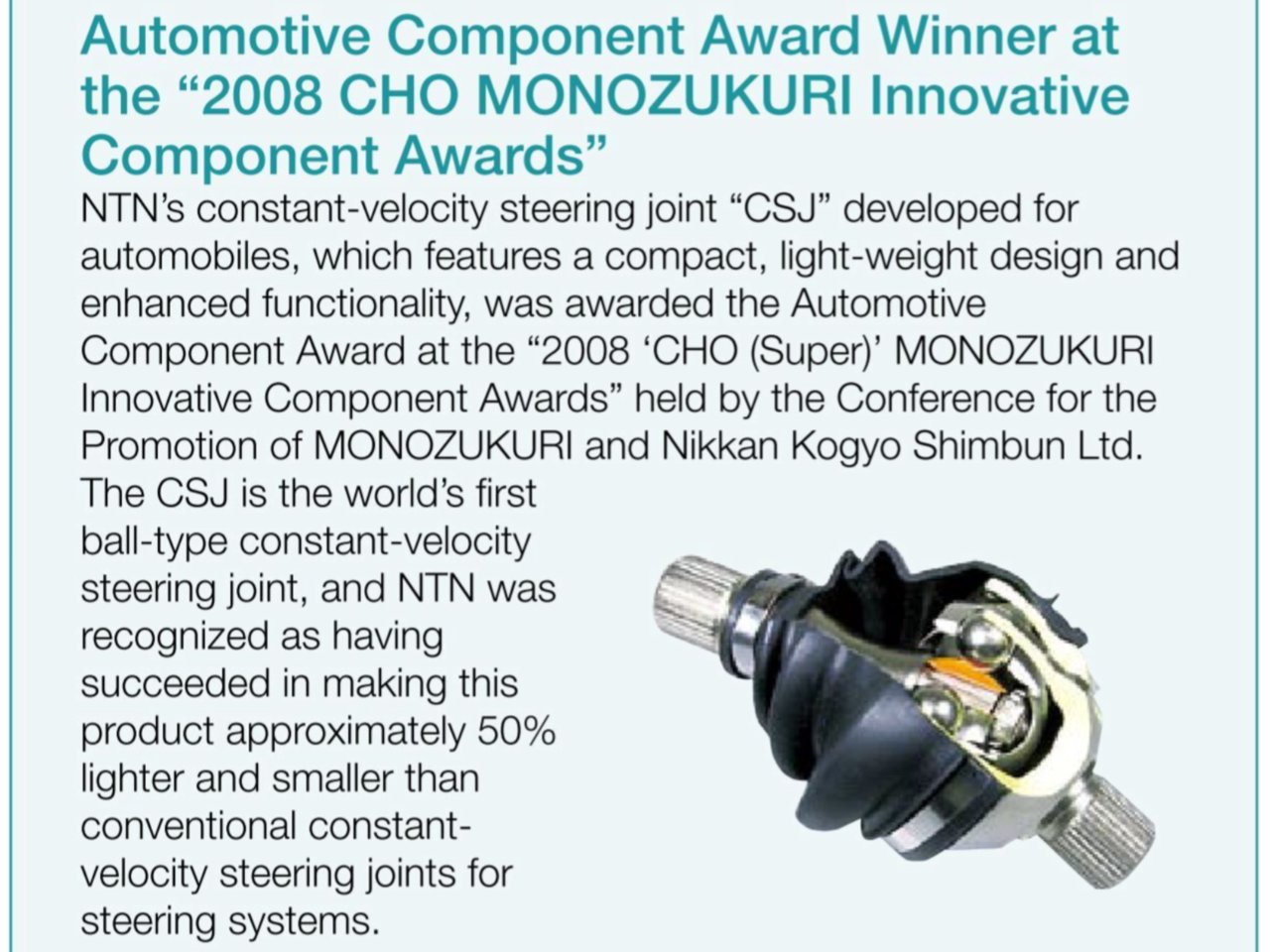

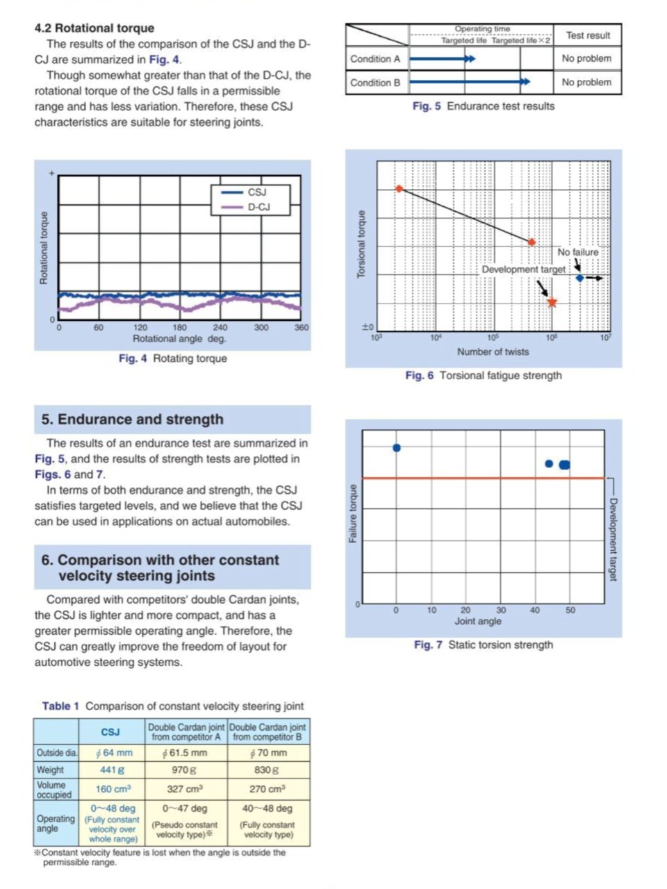

    Here's a neat little steering part I finally got my hands on! NTN Japan came up with this some years back, and the development paper is posted below. It's unknown if it has the durability to survive in our applications, but given the teensy seizing U joints that are currently used on Tacoma trucks, it's worth a look-see.
    This particular unit is from an OE GM application, the only OE app I have found thus far. Normally, it has stupid pricing, GM retails the replacement part for over $800! Some of the big parts houses have it for $400.
    The shaft spline where it connects to rack is the same as what Toyota use, BUT it is too shallow to completely engage the stub. Both upper and lower connections are crimped on, so it appears there are male stubs on either side of the actual unit, a quick trip to lathe could easily have both removed, and then two shorty male stubs will be available for adapting.

    With that and a urethane damper instead of rubber, I wonder how much of a different folks would feel. CVs over universals all day long.
