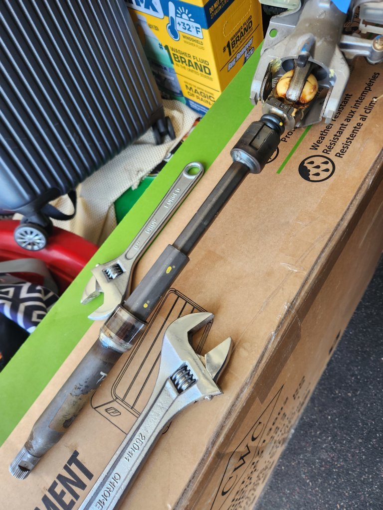

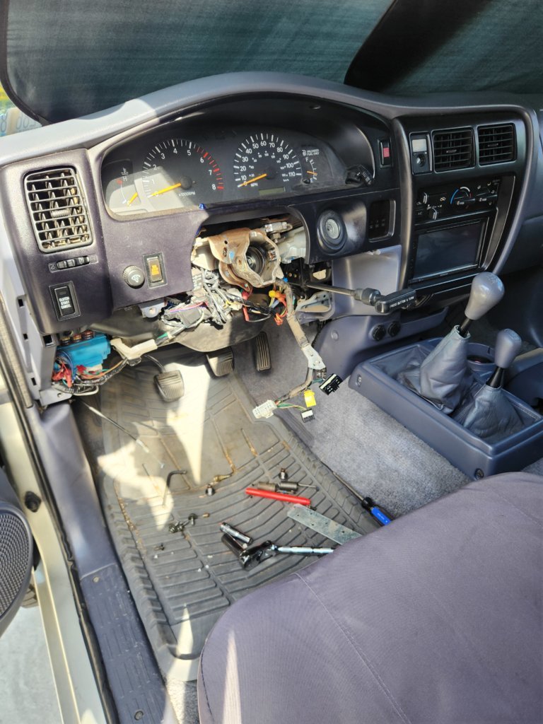

    Update for you guys:
    Had about an hour free so I decided to go ahead and pull the steering column out(since its free to do). Super easy—took maybe 10–15 minutes max. I was fully ready to tack weld it, but then I figured I should check for play first.
    I took a quick video (attached below)—not sure how clear it is—but it looks like there’s virtually no movement in the column. Like, seriously, no noticeable play at all. Definitely nothing like what I’ve seen in other videos where the shaft shifts or clunks. Now I’m kind of stuck—should I still tack weld it just to see if it helps, or leave it alone since it seems tight? Would love to hear what y’all think before I throw a weld on it for no reason.
