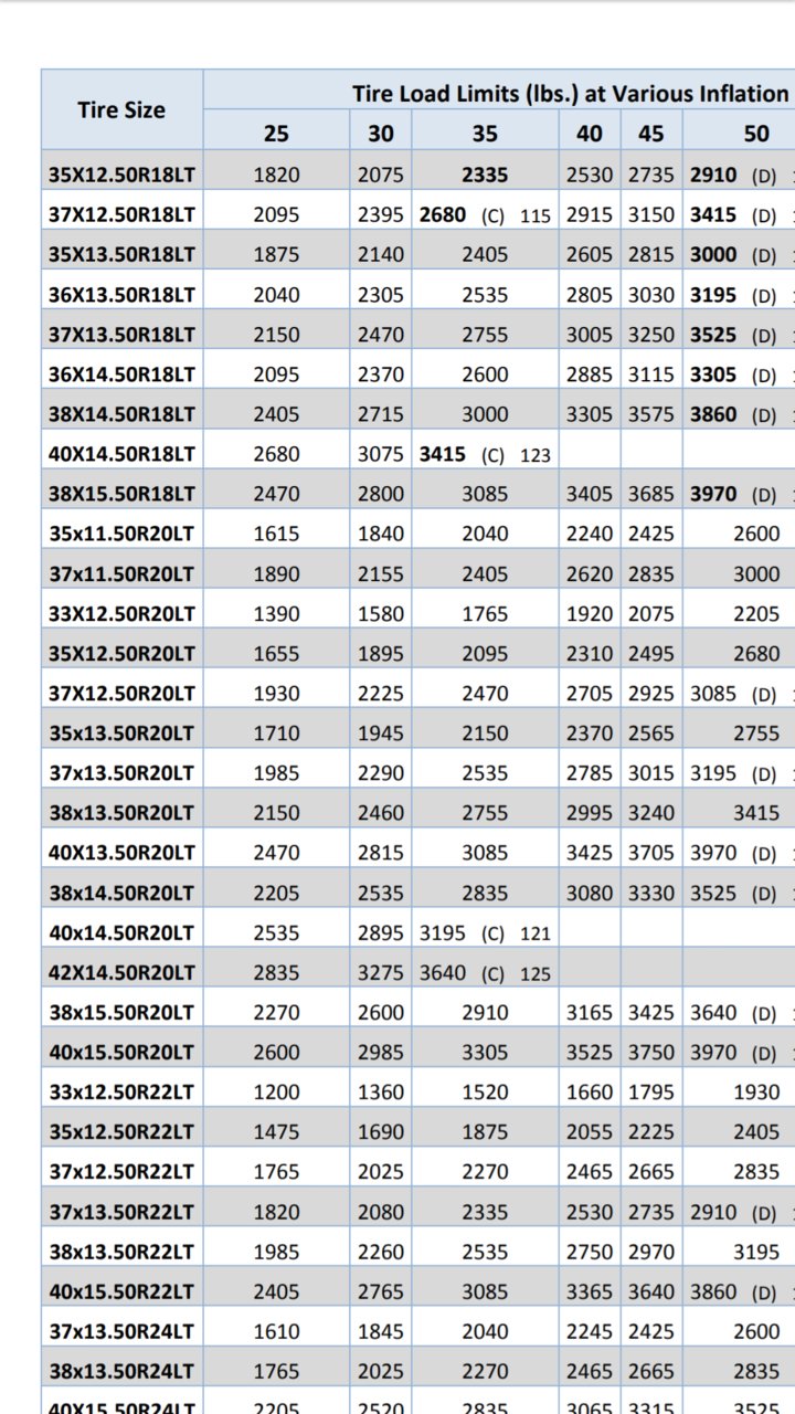

    33x12.5R20 'require' 41 psi...
    But, like Sungod said, that's not the source of your vibes.
  17. May 13, 2020 at 12:22 PM
    #17
    mlr69
    mlr69 I had a savings account before I joined TW
    May 3, 2018
    #252413
    726
    South Carolina
    2018 TRD Sport 4x4 DCSB
    2" ToyTec/Eibach Pro Sport Lift Kit -SparksParts.com 3/4" ToyTec Front Top Plate Spacer Kit -SparksParts.com SPC Performance Upper Control Arms -SparksParts.com Nitto Ridge Grapplers 285/75/17 (34") -SparksParts.com 1.25" Spidertrax Wheel Spacers -SparksParts.com Hypertech Speedometer Calibrator -hypertech.com Predator Tube Steps -SparksParts.com BAKFlip G2 Tonneau -SparksParts.com OEM Rubber Bed Mat -SparksParts.com OEM All-weather Floor Liners -SparksParts.com Gentex Frameless Mirror with Homelink @RJP869 Subaru/Kicker Tweeters -amazon.com Kicker Door Speakers (x4) -crutchfield.com Radio Knobs @Tacowiede Vehicle OCD Glove Box Organizer -amazon.com ‎JoyTutus Center Console Tray -amazon.com FormulaOne Pinnacle Window Tint -SparksParts.com ACDF Horn Kit @BartMaster1234 Total Tail Light S1 Kit @MESO ECT Button Relocation Kit @Tacowiede Minimalist Key Fobs @MESO Ultimate Map & Dome Lights @MESO Fortin EVO-ALL Remote Start w/Cell Module @jmeitz Coin Bucket with Lid @MESO GermesLab Camera Control System @FreshMexicanTaco Natika Front View Camera -amazon.com VLEDS LP Reverse Light System -vleds.com LIFTd Customs Fuel Cap Cradle @JIMMEISTER OEM Power Tailgate Lock -SparksParts.com OEM 2022 Limited Grille -SparksParts.com OEM 2022 Limited LED Headlamps -SparksParts.com LED Headlight Conversion Harness @daveeasa Headlight Trim Plates @MESO OEM Door Sill Protectors -SparksParts.com Diode Dynamics Elite Fog Lights @memario1214 Fog Light Backlighting PNP Harness @daveeasa TacomaTime Dash Cubby Drawer -etsy.com FPE Fogs + High-Beam Module @memario1214
    How do you calculate 33x12.5R20 = 41 psi ?
  18. May 13, 2020 at 12:31 PM
    #18
    splitbolt
    splitbolt Voodoo Witch Doctor
    Mar 7, 2010
    #32761
    7,858
    NW Arkansas
    2016 TRD OFFROAD DCSB MGM
    Our trucks require* a PSI that attains a 2,149 lb load rating from P and euro metric tires.
    Or, a 1,954 lb load rating from LT tires.
    @41 psi a 33x12.5R20 has a load rating of 1,951 lbs.
    *based off recommended door sticker
