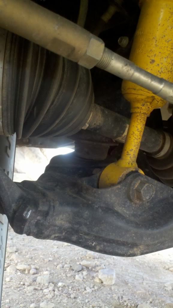

    The groan you hear when turning is the steering stop rubbing up and down on the stop pads. This is a common condition on IFS trucks. At the factory Toyota installs plastic covers on the steering stops. These plastic covers quickly wear out. Contact between the stop, and it's pad causes a quick loud groan and is especially noticeable when making a U-turn with one tire going up over something like a curb. Despite the annoying noise it's not causing any damage. There are two solutions to this noise. One is replace the factory plastic cap with new ones. The other is to toss out the plastic caps and put a little dab of grease on the steering stop pads at each oil change. With will keep the noise under control.
    I found this pic online, im not sure what kind of vehicle it is but it might give an idiea of what you/we are looking for.

    Had my appointment today with the dealer... They said there is no fix for it other than them lubing it. They did the lube today on my Steering Stops and I went out a tested it out several times with not a single noise! I guess that is the only way to fix it is if it starts to act up get it lubed by the dealer or do it yourself. If I knew where it was on my truck I would do it myself but I looked and cant find anything like the photo above.

    Handy photo, thanks.

    its located right under the LCA's and behind the wheel. Ill try and get an actual pic of my 06 Tacoma so you can better locate it.

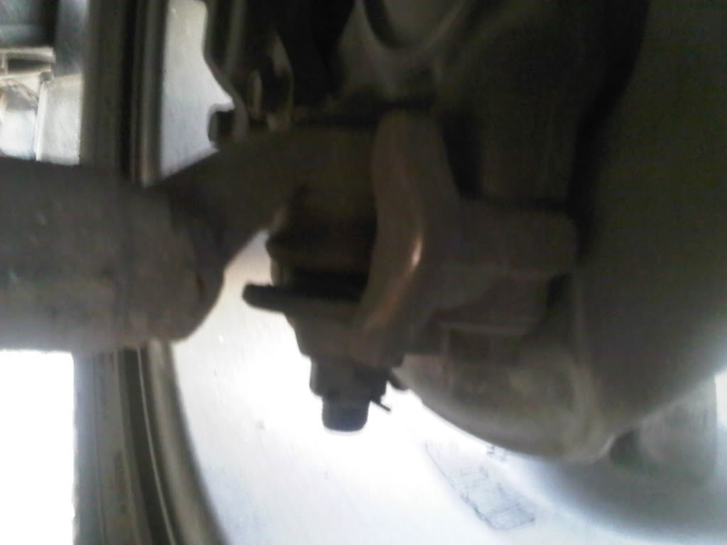

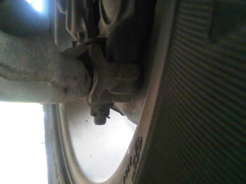

    Sorry about the cell phone pics, but here it is :
    Wheel straight
    Wheel locked

    According to your pic's what exactly am I trying to lube here and where to help stop this clunk sound when making an extreme turn?

    The part that is shiny is your steering stop on the LCA. There is one on each side of the LCA, on both LCAs and one on each side of the knuckle on both knuckles.
    I was thinking of melting some wax and dripping it onto the steering stop. I'd prefer not to have grease and dirt everywhere.
