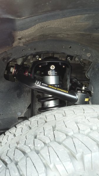

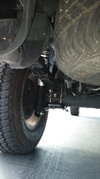

    Here's some images of the lift...

    Does anyone think it's worth getting this thing re-aligned again? It's in spec on the camber, but I assume barely. I don't know the actual specs. Does anyone know where I can find the specs? Looking at my before and after numbers, the camber got worse.
    Before and after the alignment:
    Before:
    Camber: 1.09, 1.09
    Caster: 3.84, 3.01
    Toe: 0.23, 0.28
    After:
    Camber: 1.23, 1.11
    Caster: 2.47, 2.38
    Toe: 0.01, 0.02
    It seems like they adjusted the caster and toe and just left the camber since it was in spec.
    ICON recommended that the caster be right on the high side of the spec if possible. I have a friend with a BMW/Merc shop that do the alignment and get whatever numbers I want. What do you guys think?
  4. Dec 29, 2016 at 4:57 PM
    #24
    spiralout462
    spiralout462 Well-Known Member
    Sep 16, 2012
    #87068
    1,792
    Eastern Shore VA
    2015 4x4 dclb
    Icon suspension '15 toyota nav TRD FJ SE anthracite wheels Weathertechs Trd pro pieces
    You want close to 0 degrees camber. As close to 3 degrees caster as you can get. Forget about "specs". They apply to factory geometry.
