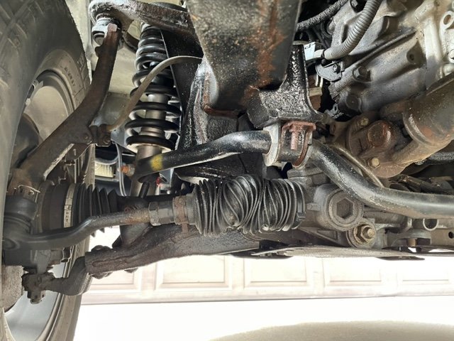

    Hey all. I took my 01' double cab in to the shop because the steering has been real weird lately. They rotated the tires and said it's fine. Driving it home today it felt worse.
    Crawling underneath, I found this part of the steering rack that seems to be all bound up? Could this be the culprit?

    That looks like it's just swelled up from being oil soaked. Don't think that would cause steering issues. What exactly does the steering feel like? Have you had the upper and lower ball joints checked recently?

    What you see there is just a boot, it looks to me like when the toe-in was adjusted they didn't slide the clamps around so it's just twisted. You can loosen the clamps and adjust it, check for leaks inside it, but if @mechanicjon is correct and there's fluid in there, there shouldn't be.
    My '03 has a similar problem, it handles perfectly with one flaw, let go of the wheel, it drifts right. I was told in 2018 it's a steering rack and LCA's (or just LCA bushings,) but not sure. So I replaced LCA's and ball joints, had it re-aligned, they're saying it's strut bushings(shock bushings) but "don't rule out a steering rack."
    In your case look up and perform the tests against the tie rod ends and upper/lower bushings, it's pretty obvious when they're really bad (briefly, check for play at 9/3 and 12/6 on the front wheels, rock the top of the wheel on the ground and look for play in uppers ball joints or bushings.) Otherwise it may be the steering rack or maybe just the bushings, do the tests against those too. Here's how you check the lower ball joints.

    So I should drain those boots? There does feel like there is fluid inside the left one.
    This truck has a mountain of service records, I was digging through it and it appears the steering rack has been replaced 3 times, once when it was taken off lease in 03, again in 06, and again when the frame was replaced in 2016. I'm thinking the steering rack might be the problem. Luckily my uncle's brother is a part collector and has one I can take, just have to get to kansas to pick it up.
    Just went out and tested ball joints with a bar, there is no play, and they looked fresh. That video is super informative, I've seen trucks with their wheels splatted out on the highway before, glad to know how to check and do preventative maintenance for that now. Lower control arms also appear to have been replaced recently. Just found a coffee stained invoice from 2018 showing they were replaced.
    Thanks for your helping me pinpoint the problem. Is it normal for a first gen to tear through steering racks? Mine is up to 300k since I last updated my bio, it feels weird to have that many steering rack replacements in that amount of miles, but I don't have any knowledge on the topic
    Guess it's time to set out across the prairie and pick up a steering rack. I can't complain though, free part and I get an excuse to drive my dad's FJ across the flint hills.

    I'd be sure that's what the problem is first, and I'd investigate the boots. Odd that you've gone through so many racks.

    i wonder if the drag of the boot on the inner tie rod is enough to cause the not returning to center .

    If there's fluid in those inner tie rod boots then the rack seals have failed and you'll need a new rack, or rebuild that one. Not supposed to be fluid in there. Common for them to leak a bit with age, but if it's "full" of fluid that's a problem

    That boot didn't do that by it's self. It does not turn when you steer. Looks like some one did not loosen the boot clamp when they adjusted the toe. Look at your other side. A little oil in the boot is not unusual.
