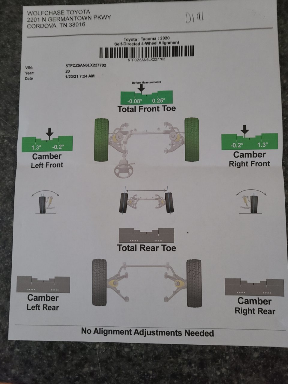

    I just went into the dealership yesterday for the same issue ('20 TRD OR stock, 10,000 miles) dealer said it was in spec and that's just how the truck is. Attached is my alignment numbers when they checked it. I asked if they could make any adjustments which would help and they said no
    I'm going to look for a local front end shop for some recommendations

    Where’s the caster reading?

    Did they include a sheet with Caster on it? That's the spec also matters here, quite a bit.

    Total toe but not individual? No caster? Wtf kind of hack job alignment are they trying to peddle? If left toe is -2.0 and right is +1.25 total will still be "in spec", but it will drive like shit and want to pull left one second and right the next.
