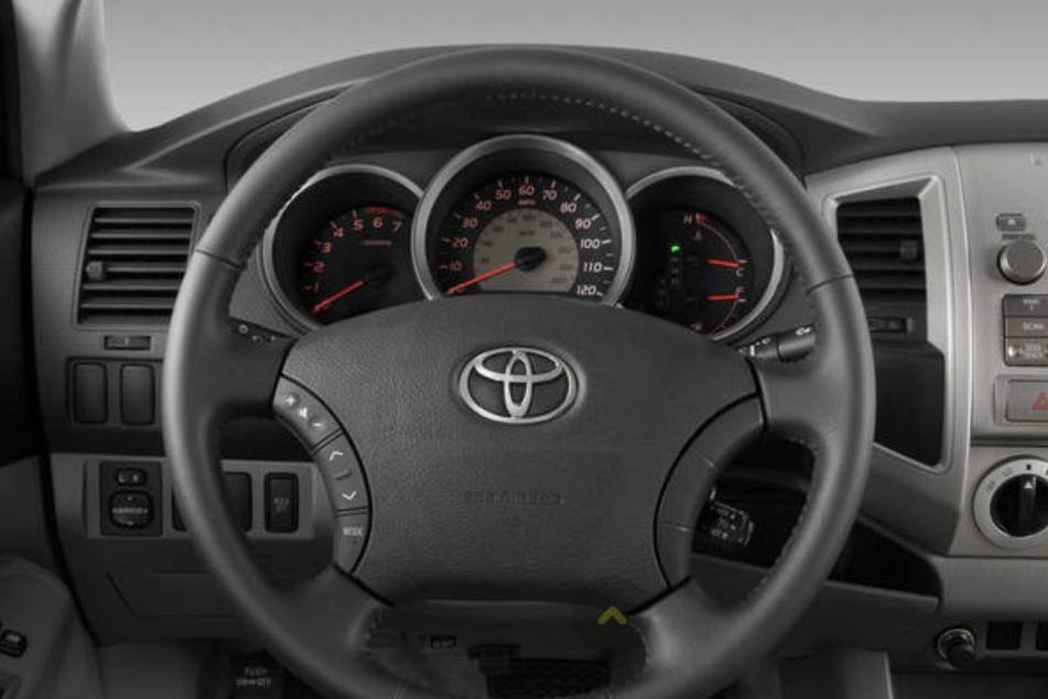

    steering wheel keeps moving. Anyone dealt with this? What was the fix?
    Alignments are a waste.
    I've replaced most if not all of the front suspension. But despite that, it moves. Like it has a mind of it's own. Sometimes after sitting cold overnight, sometimes on impact while driving.
    Sometimes it's straight, other times a bit left, or a bit right, or VERY right.

    Long story short, the steering wheel has a mind of it's own. Before I tear apart literally everything to investigate, anyone have any ideas?

    When you say moving meaning it clocks to a different location but tracks straight? If so, that’s a symptom of your suspension hardware being too loose or not quality. Do you have oem lower hardware? The MOOG bolts are known to be shit. Also I’d recommend aftermarket LCA tabs, and Worst case once you get a good alignment tack weld the cams to the backing plates.

    OP, the factory spec. for movement of the steering wheel is a max. of 30mm measured along the outside of the SW so you could easily have it coming to rest in different positions. Measure with wheels on ground, steering straight ahead.
