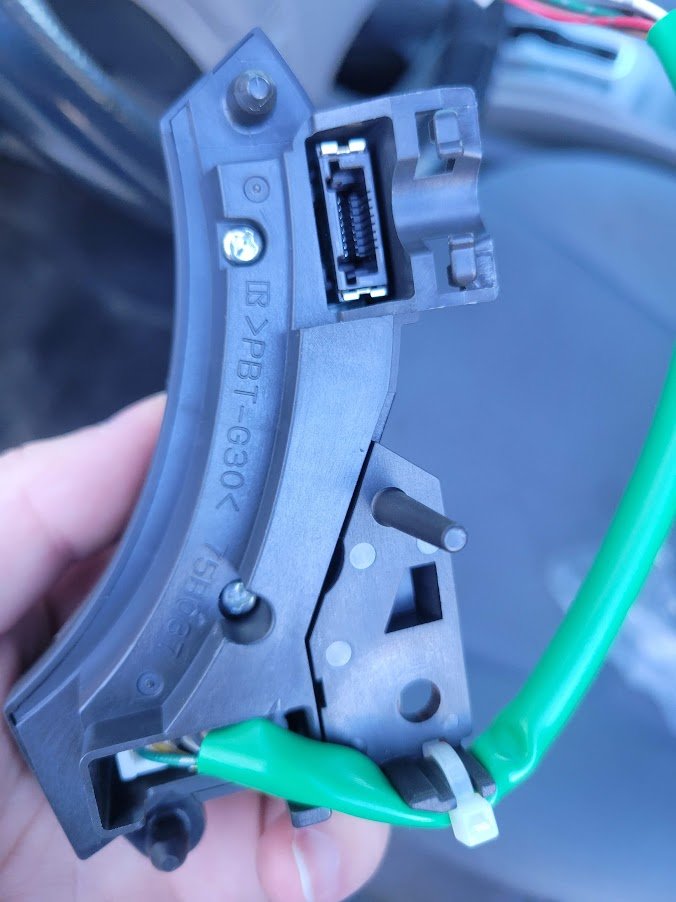

    I got https://www.ebay.com/itm/231513078192 this for buttons, should be here on the 10th. I don't remember what clock spring I got but it's different and has a 10 pin. I haven't gotten a right side yet because I'm not sure if it'll work.

    275CyaxNMe22a0F2IOOPPiwO1-iKsZu_gXtUB51B_869b93c3d83cff3174b6be5625fab4761b09c14a.jpgJBNsiTN2alc0cY4tk_wbwrN_S5WV7UMeq7ugcnUY_cec2060c46f43f8c8a29683b7d19be68fc26cb94.jpg

    ahh ok that would the older ones I thought you were going for a newer version.

    so the right side buttons if I were to get them will still work over the three wire connection out of the dash? (Uses 3 of several pins in the plug)

    The right side connects to the left side with a ribbon cable.
