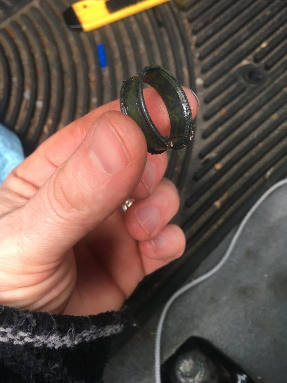

    So this is the culprit in the photo attached. I can only assume it popped out when I replaced the lower steering column and there was probably some wiggling front and back on that column.
    When I took the plastic cover off the ring was just sitting there above the joint.
    I just ran four zip ties through the joint and so far it’s running like a dream.

    Was reading this and went out and checked mine I have slight play but can’t get my smallest zip tie in but while i was checking that I noticed my retaining clip that has teeth was down on the shaft not on the groove I believe a tooth broke off is why it won’t go back into the groove. i used a zip tie to hold it in place. Is this alright?
  15. Jul 8, 2022 at 7:54 AM
    acparker12
    acparker12 Well-Known Member
    Apr 5, 2022
    #394358
    128
    Penns Valley, PA
    2014 MGM Tacoma TRD Sport 4x4
    Still figuring it out…
    I would think it would be alright since it wasn’t holding anything and the zip tie put it back in place so it won’t drop to the bottom of the shaft. It’s loose it don’t grip on the groove but I don’t see why that wouldn’t be fine. Let me know if I’m wrong.
