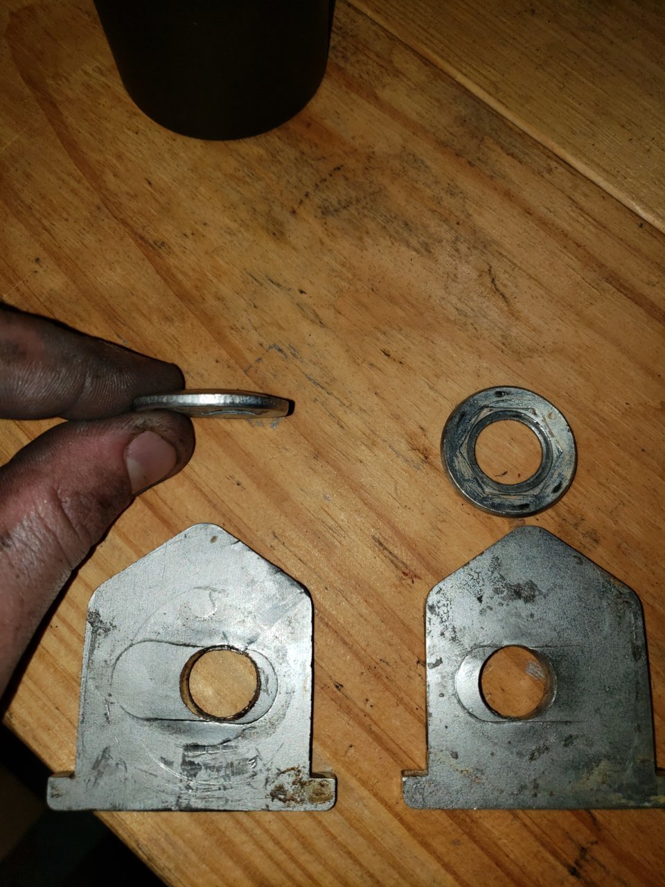

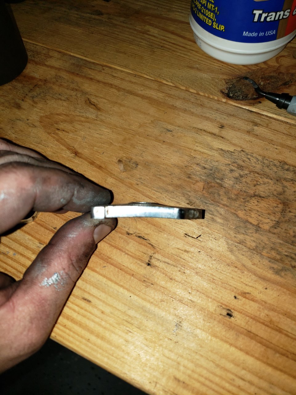

    I have the Energy Suspension bushings...here's what I found today.
    The Taco Tabs are buckled on the driver side control arm. We'll see what happens when I replace them.

    Specified torque is 250ftlb. They fit nice. None of the others were loose when I checked torque today. This one was mangled though.
