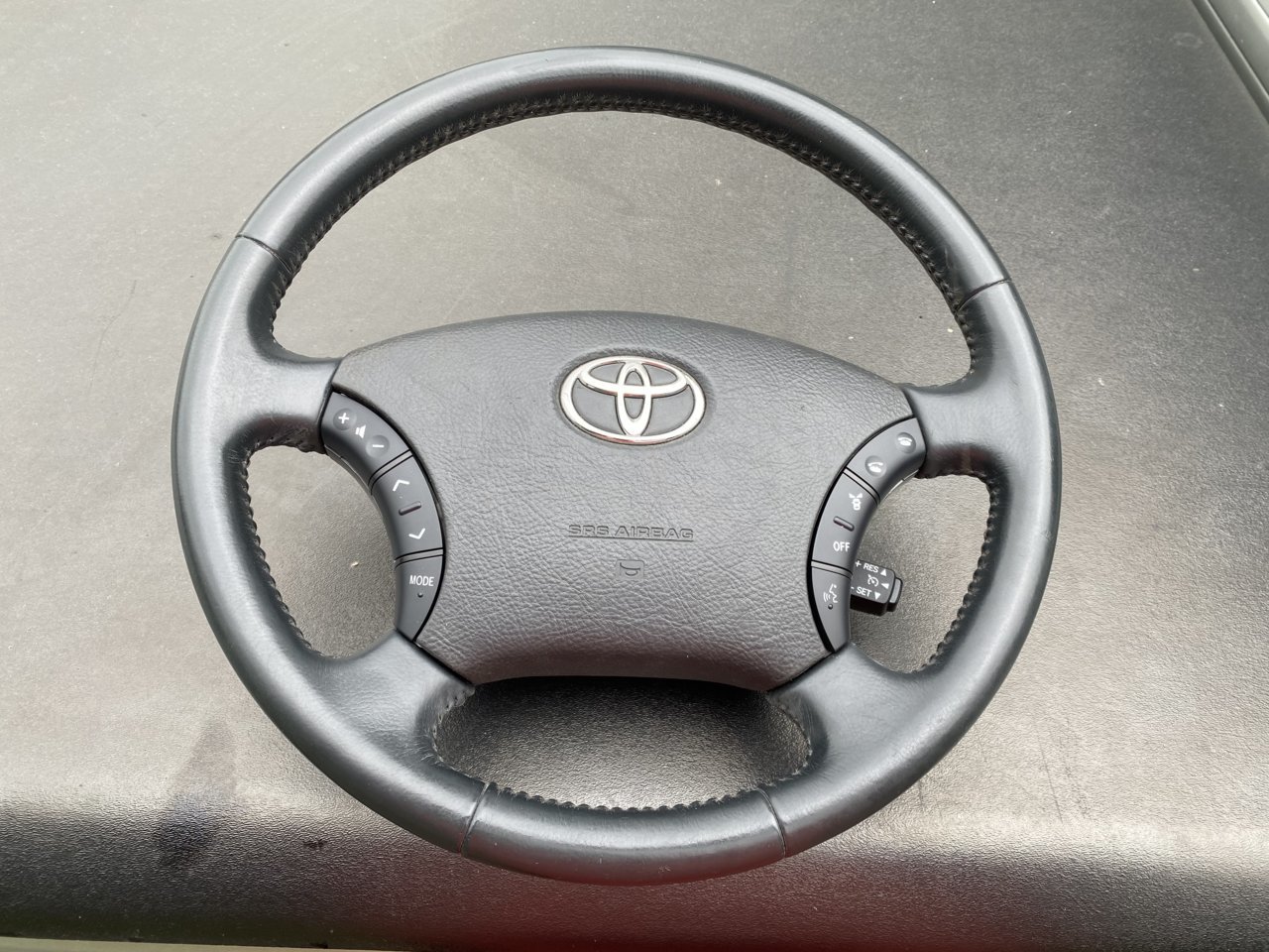

    Just got my Dark Grey 4Runner steering wheel with audio controls, going to try and do the retrofit into my 2003 Tacoma. PLEASE, any pointers suggestions would be helpful as i take on this MOD, I am waiting on the airbag and I also want to change the turn signal stalk to one that has the fog light switch on it as well.

    The cancel cam is part of the whole thing that holds all the switches. Find one used off a sequoia, 4gen 4runner 2005 tacoma.

    Thats the one. I have a turn signal lever with the fog light switch I'll sell. I need to pull it out and check for sure.
    Wire pigtails are the next hard thing to find.
