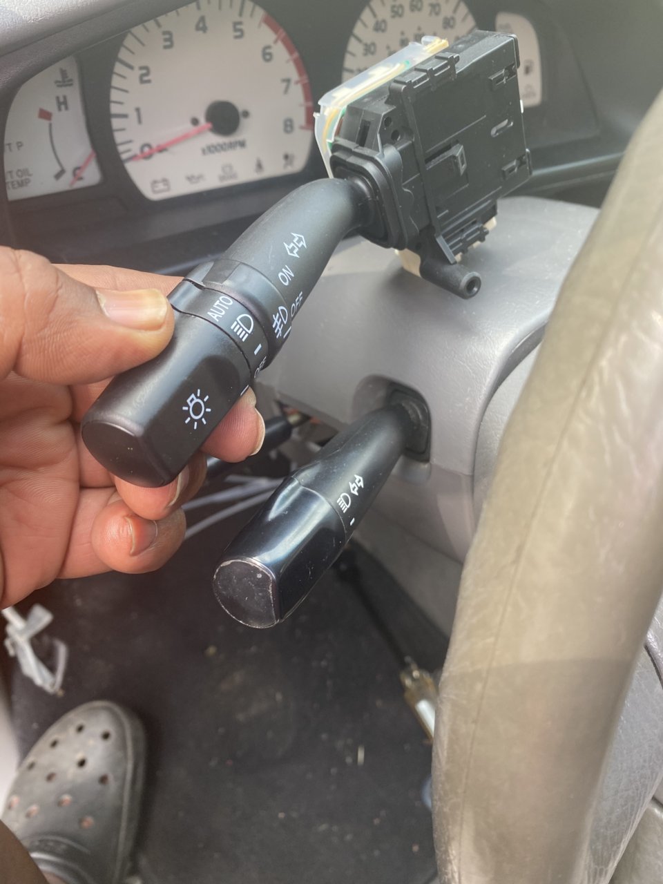

    No, the switch is non model specific as per my supplier, it’s just for Toyota Models in the European and JDM market, some USDM models do have them, but very hard to find. You mentioned that they are Chineese knock offs of the original OEM Toyota and I asked my supplier SoungYoung Inc. and they said that they are duplicates. I did not know that. They are pretty good copies and they work great. The buttons are simply a resistor value each time you press any button, you can actually program them to do whatever you want it to do. The clock spring connector is from a Sequoia and it has extra pins to add more wires if you need to. I am also trying to retrofit this Chineese stalk below, for the extra buttons of the “AUTO” lights on feature and the fog light switch.

    Will that stalk bolt in? if yes would you mind sharing the part number or how I can get one?
  6. Oct 30, 2020 at 7:40 PM
    #206
    gusto11071
    gusto11071 Well-Known Member
    Jun 17, 2020
    #331669
    744
    Juan E.
    Brewster, NY
    2003 Tacoma Ext Cab DLX 2.7L 4X4
    Rear FJ Cruiser Disc Brakes, Front Tundra Brakes, Heated 4Runner Mirrors, 2018 Tacoma OEM 18" Wheels
    It’s a Chineese Replacement, I just searched for Toyota Stalk with “Foglight” Option and the “Auto” on the stalk, I got it off AliExpress. I would have to check for their part number. It’s not actually a direct bolt on. But, you can make it work. Also, I have not finished the “Auto” part yet, and I am currently working on the Foglight switch part. I will keep you posted.

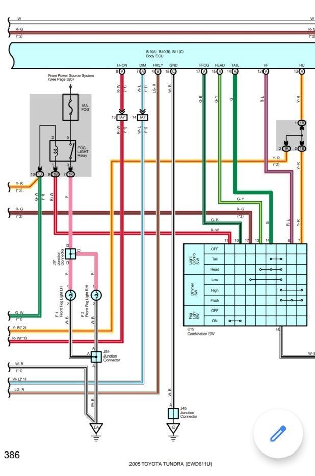

    I actually can help you do the auto section really easy I have it on my truck now and it works great I would just love to use this stalk as a switch instead of the toggle it comes with.
    if you get a DEI 545t it will give you a full auto light function that uses a light sensor so the lights will automatically come on when its dark
    Here is the wire diagram the switch I circled is the one you would interface with the stalk!
    ireymon likes this.
  8. Oct 31, 2020 at 8:09 AM
    #208
    gusto11071
    Jun 17, 2020
    #331669
    744
    Juan E.
    Brewster, NY
    WOW! Exactly what I had in mind, this is GREAT NEWS! Thank You so much! I see what you mean on the switch function.

    I just started looking into this using that exact kit! So you're happy with it, no problems? Install looks relatively straight forward at least on paper.
    I just bought an is300 headlight stalk which has the auto headlights. Looks like it might be a direct fit unlike the one just posted previously. I'll be able to confirm Monday when it arrives.

    It actually arrived today! I'll try it out tomorrow and update. If it fits, maybe we can start a auto headlight install thread!

    Wow superb find man I love it! I like the little grey in the stalk too nice litttle touch!

    Did this work?
  17. Dec 8, 2020 at 2:14 PM
    #217
    Plkyone
    Plkyone Well-Known Member
    Nov 3, 2018
    #271563
    275
    I don’t think he went any further with those original stalks because the IS300 stalks are plug and play

    YUP
    I took off the Sequoia stalk and used the plug and play ones from the IS300
