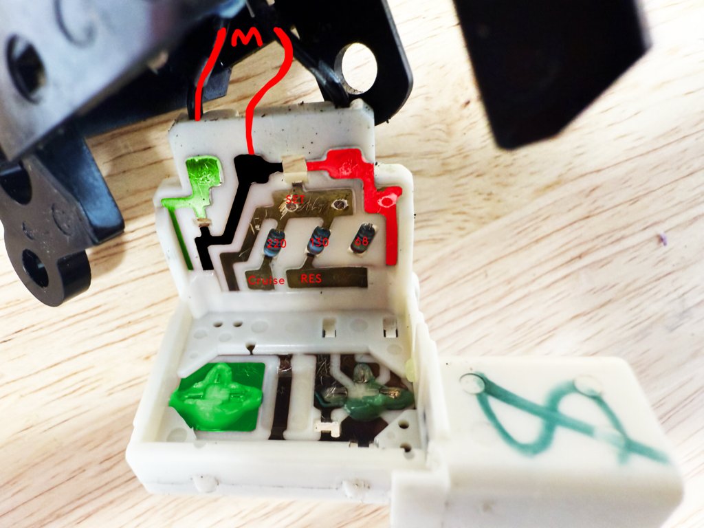

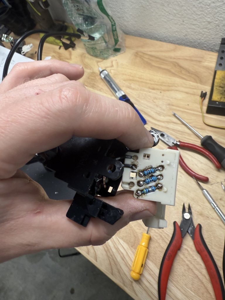

    Just wanted to share another interesting part of this build. Ended up tracing out 2 wire cruise switch, and finding out that it's wired to support 3 wire operation with the following changes:
    1. Swapping one of the leads to the on/off switch to the alternate position in the middle.
    2. Replacing the resistors for values matching the first gen tacoma, in my case 68 ohms, 130 ohms and 220 ohms. I didn't have 130 ohm or 68 ohm resistors laying around, so I used a 47 ohm and 100 ohm resistor and it worked fine.
    To replace the resistors with 1/4 watt ones, I had to notch out the recesses in the plastic with an xacto knife to fit the bigger resistors, and abrade the contact areas before adding a dab of flux to get solder to stick to the brass pads.
    Wire colors matched up without any changes steering-wheel side.

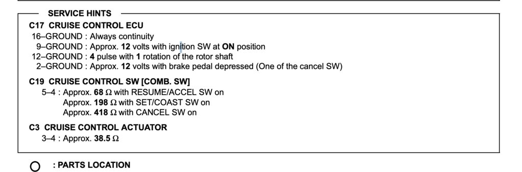

    im assuming for my case being a 2004, the values are 68,198,and 418. i assume id just be swapping your 130 for 198, and your 220 for 418 in same place?[​IMG]

    update: if your values are this, this is the part # to the cruise control stalk that is bolt-in no wiring needed. i got this from a 2004 4Runner. I also took the circuit board and retrofitted it to my 2006 tundra wheel switch/button assembly
    for my 2004 tacoma, i used:
    -2006 tundra limited wheel
    -2003 sequoia wiring, air bag module (4 8mms), clockspring
    -2007 sequoia turn signal cancel (can use anything from this style wheel)
    -2004 4runner cruise control stalk, and button circuit board (orange lights vs. green)
    -axxess aswc-1 module
