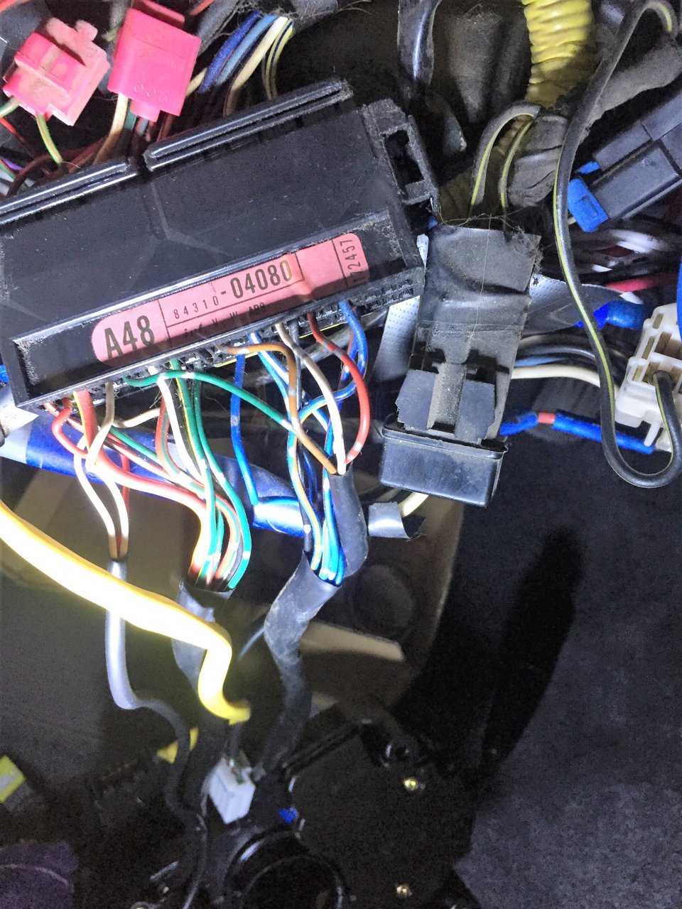

    OK'' Back in Business, this time Correct CS...............Hope to get the plate sometime early next week. ;)
    In the mean time, going to review the Electrical diagrams....
    All is appreciated. ;) Thanks

    I can draw you up a diagram if you'd like.
  11. May 3, 2018 at 9:15 PM
    #111
    Birdog
    Birdog Well-Known Member
    Mar 4, 2015
    #150124
    143
    West Coast, Valley Boy
    1st Gen Taco 4x4 SR-5 13th one off the line in Santa Clara May 13 1995. Many mods to it, still showing her force.
    K&N Filter, Boral Exhaust, Posi Trac, CBI DIY front Bumper, Mod front grill, Mod HD lites, Icons mod Front, Rear, & Stero System 7 inch Alpine, with mic, and USB, ipod,, New Carpet, New Suntop Camper shell, Carpet kit rear, Yak roof rack, Rola Cargo basket, Rock Lights,
    Sounds good '''' Thanks'''''''''' The Taco Wire Harness of ABYSS , dammmmmmmmm....... Good luck ''

    Here's the wiring color codes for the turn signal. You'll need to verify the function of your original wiring. Do that with all the original switches plugged in.
  13. May 4, 2018 at 12:24 PM

    Here's the one for the windshield wiper.

    Got it, thanks, projects for today . !!

    Got the Chart, Thanks, pulled /Dis - Connected the column harness, I know --- supposed to leave it connected. Just wanted to see I can cheat a little, with just matching up the pins off the chart to the pins on my connectors.....On the Black Main connector there are small numbers to identify the Pin#. if you look real close. Looks like the Harness, has (2) connectors, the one with all the blue wires is for the W/S wiper system, the other one is for the HD lights/ T/S switch. As you can see if we cross the numbers with the pin/ colors, were kind of off. Pins do not match up some pin holes are empty, some of the colors I do have on the charts, but some I don't have ? Thoughts '''' Bump'

    CC Wires........

    That's why I included a description of what/when the wires would have power or ground. Wire diagrams are notorious for being wrong.

    The first row of pin# on the spread sheet are from my switch pigtails.
