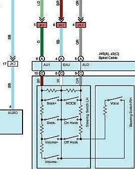

    Don't ground the ohm meter to the plate. We're needing to determine the switch common. Hook the black test lead up to the common wire your testing coming out of switch.

    On the Radio controls, Question: Since mind will be a little diff, Going to use Axxcess-1 module. In this photo which wire would be the ground wire. The EAU, ?. ........ Thanks ....
