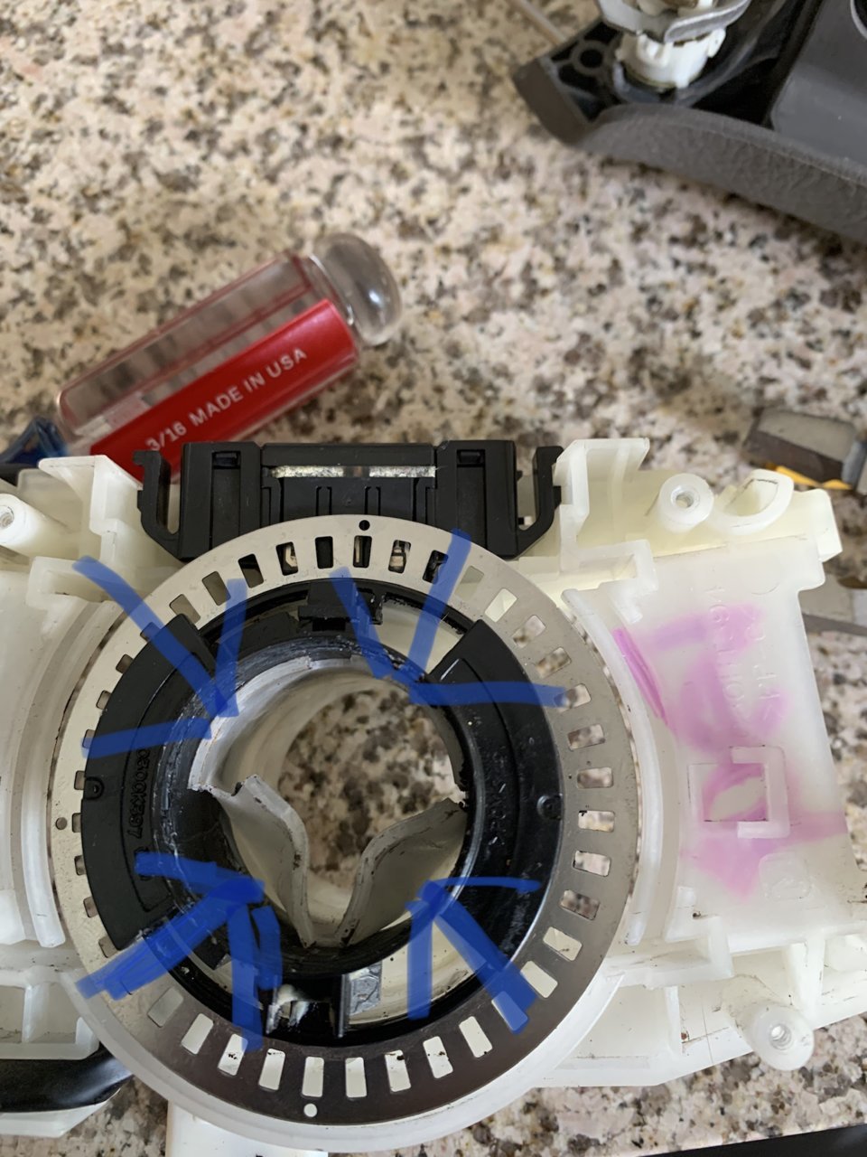

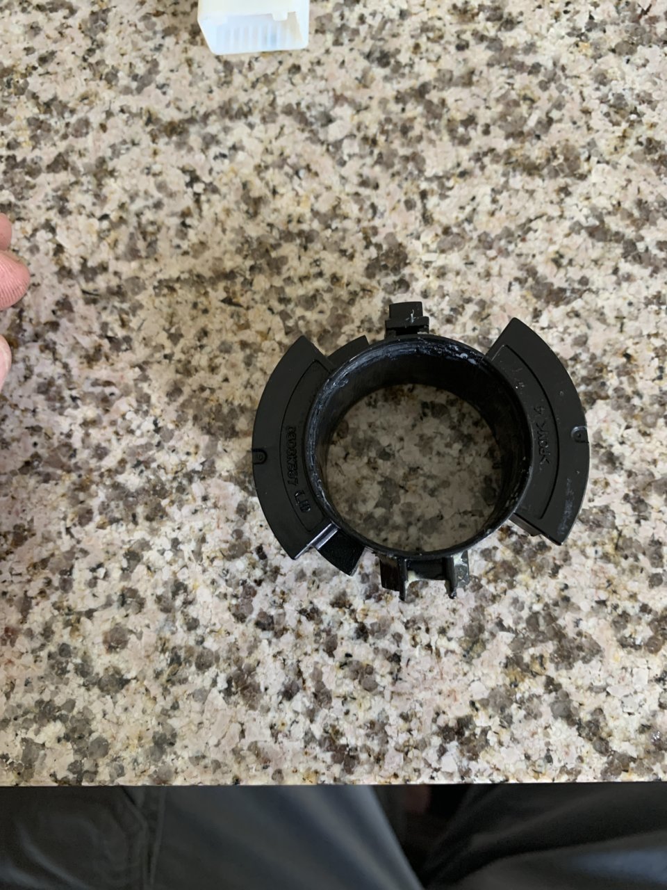

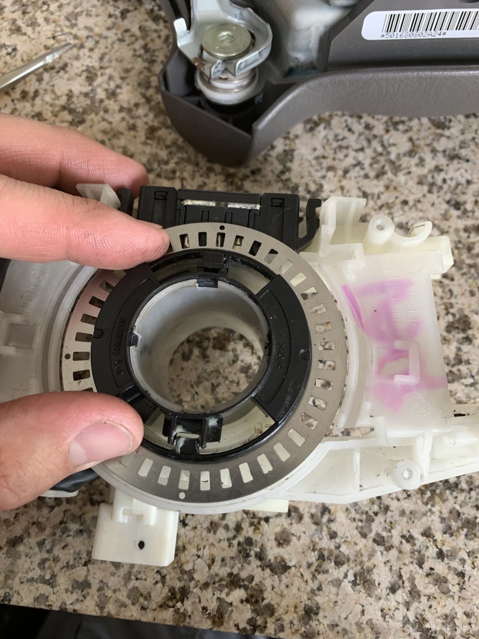

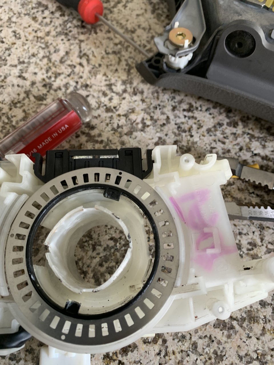

    Retrieving cam cancel off sequoia
    Push ear towards the center with screwdriver
    should slide out
    There she is
    all credit goes to @mechanicjon for guiding me through this...Thanks Jon

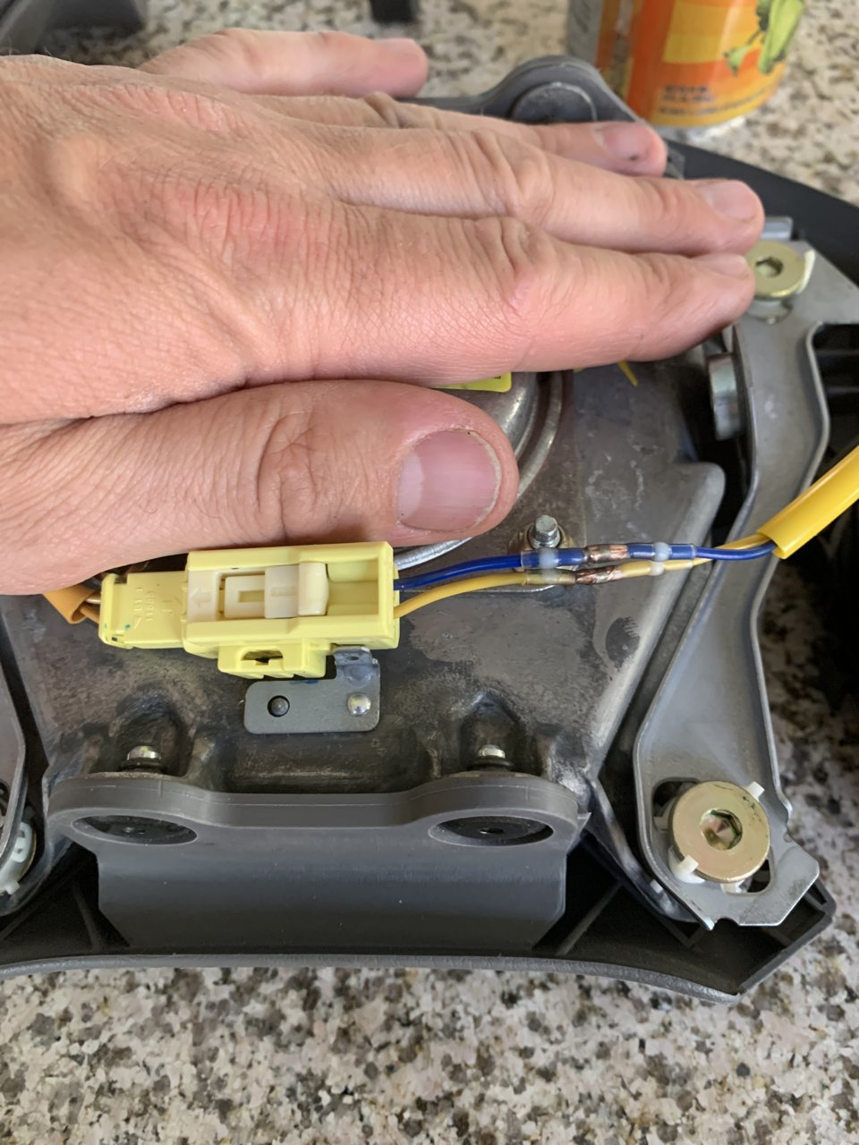

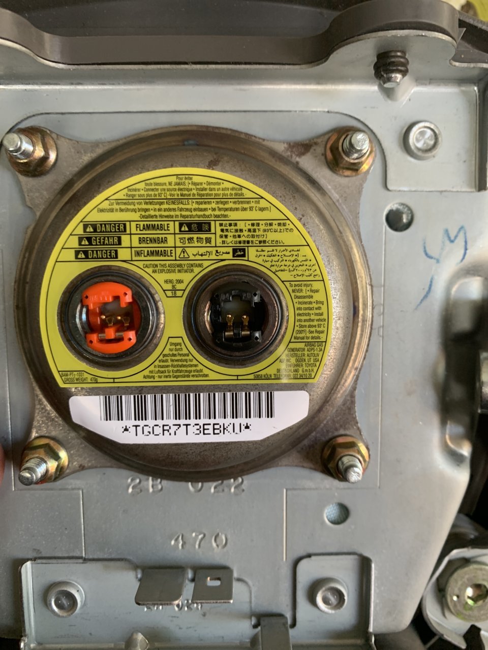

    AT YOUR OWN RISK!
    My Camry steering wheel airbag did not come with the single plug, Came with a double

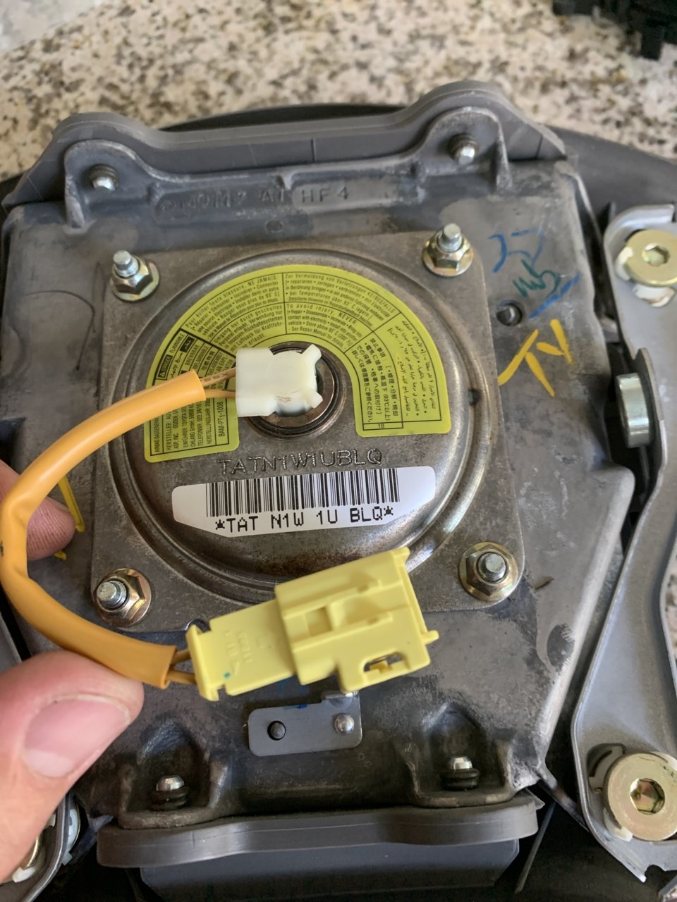

    My original 02 Tacoma one looks like this

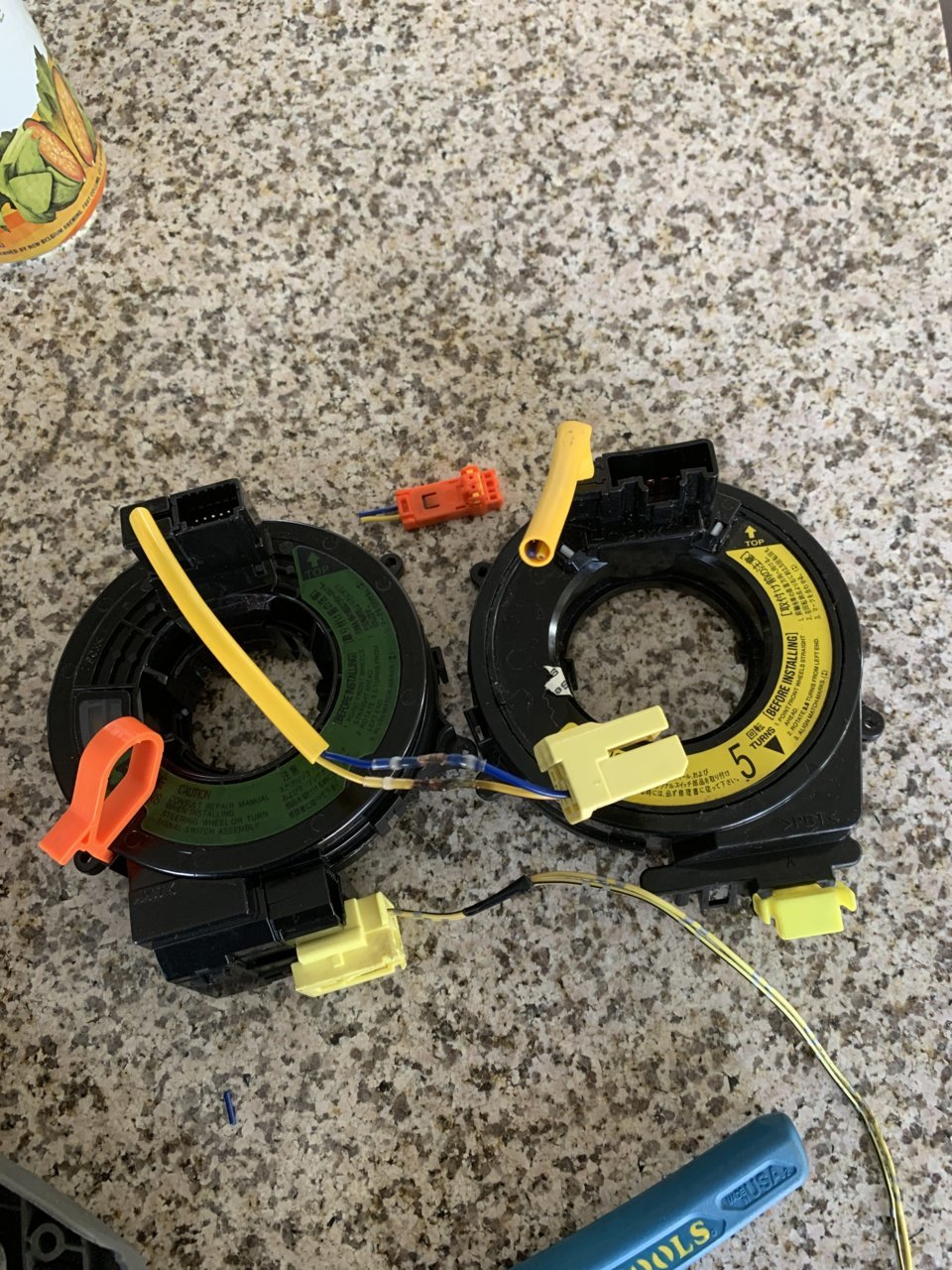

    So, I cut the harness off my old coworker Spring and put it on my new clock spring. As you can see below the colors match so blue to blue yellow to yellowimage.jpg

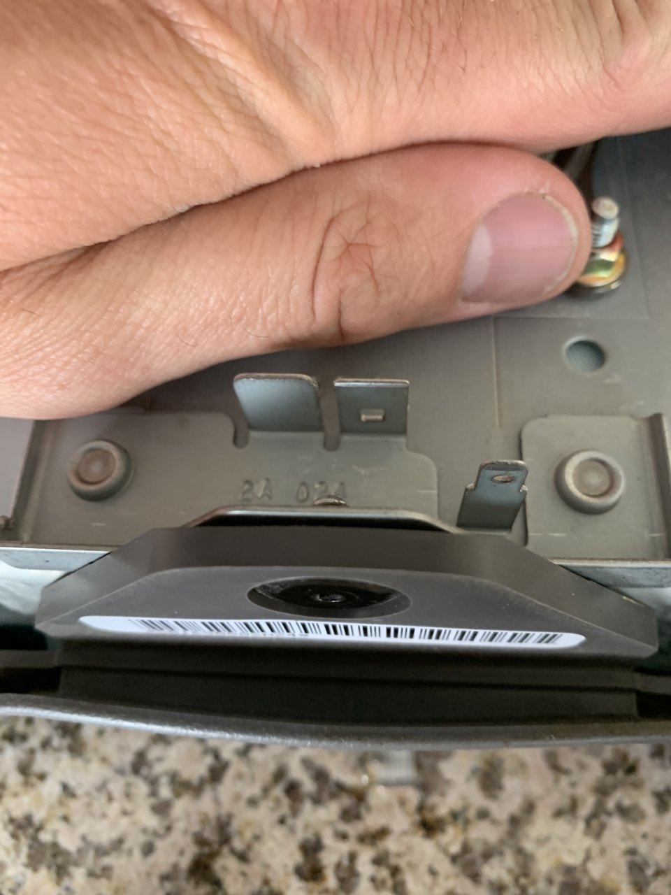

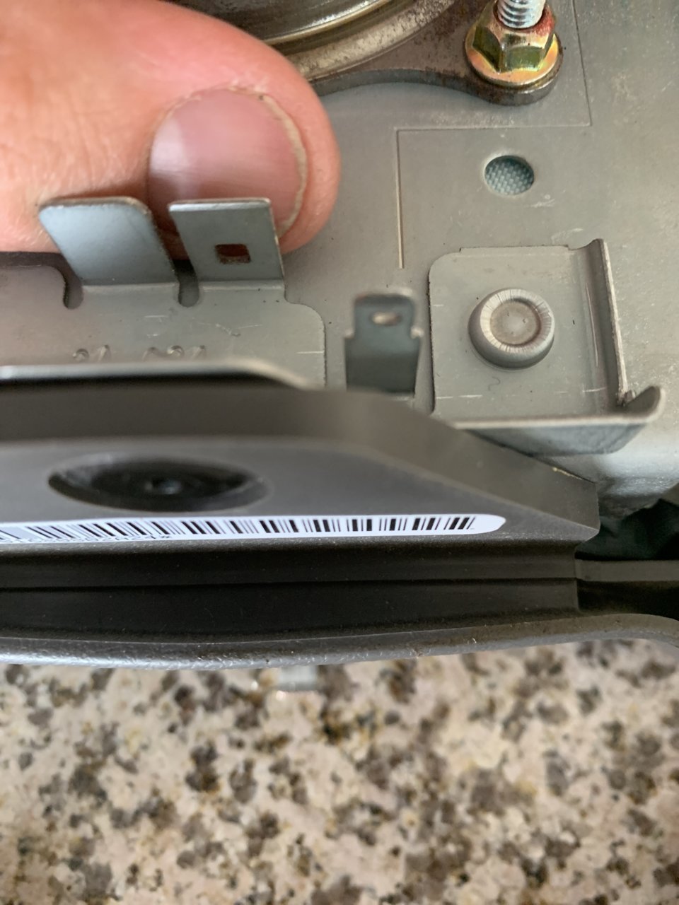

    now just working on finding a place to mount the connector. The new airbag cover does not have a slot to slide it on to like the old one does
    new
