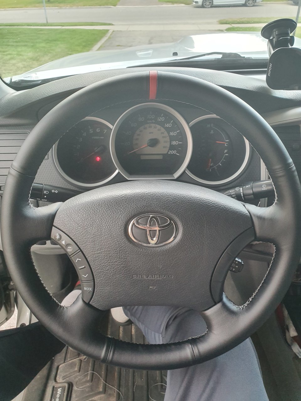

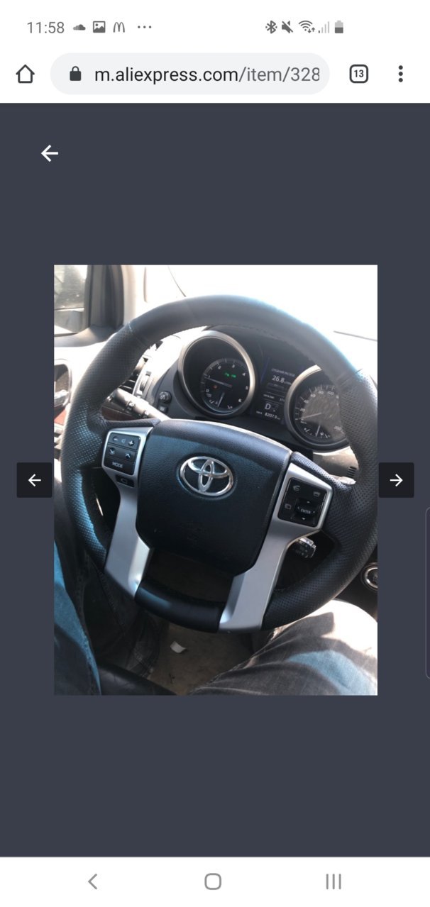

    If you have the time, for $20 you can transform your wheel with an Aliexpress cover

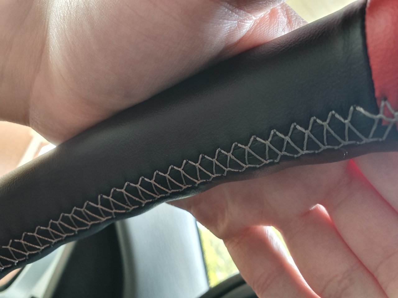

    It takes a lot of adjusting to get it perfect, I found that it was best to start in the middle and work your way into the corners. You don't want it too tight or else it will crease and you will have ugly gaps. You want to thread everything through then evenly tighten it just so that the leather meets, if you tighten too much the leather will overlap and ruin the adjacent side of the wheel cover

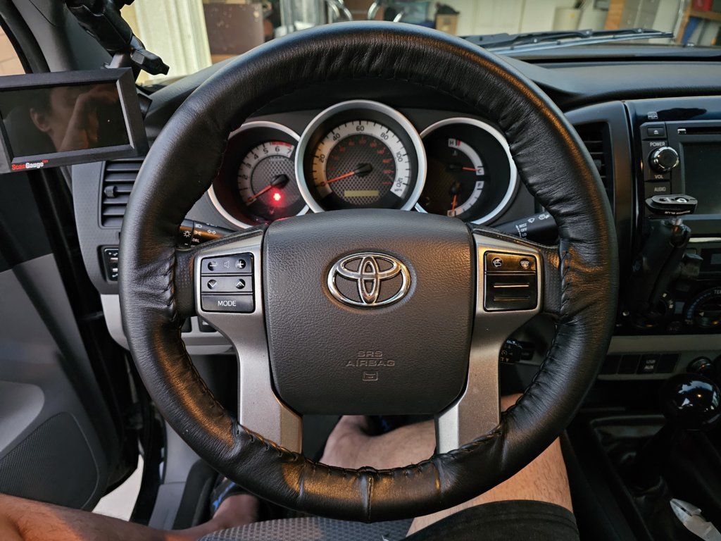

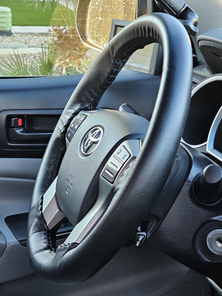

    Installed Wheelskins on 11/17/2024, we'll see how long it lasts.
    Had to ask for a replacement because of sizing issues, replacement (no vost) was worse so I just decided to insert fillers (in the top portion of the wheel cover) to avoid loose sections after stitching. Turned out okay, I think. I'll leave it until it needs replacing again.
    I'd definitely recommend, just be patient with the sizing ('cause it might not be right the first time, or at all in my case) and installation.

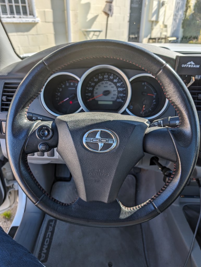

    I'm sorry but all these Wheelskins covers look like crap. It's not due to the install, it's the design. Why do they not go all the way to the airbag and steering wheel controls. Of the ones posted I'd take the Rakuten and Ali Express ones over it any day.
    As a third and fourth option you can always swap to a different wheel, I put a Scion iQ wheel in mine because I wanted a smaller diameter wheel with the flat bottom to clear my legs while driving and turning the wheel. Got tired of smacking my hand into my leg whenever I was turning.

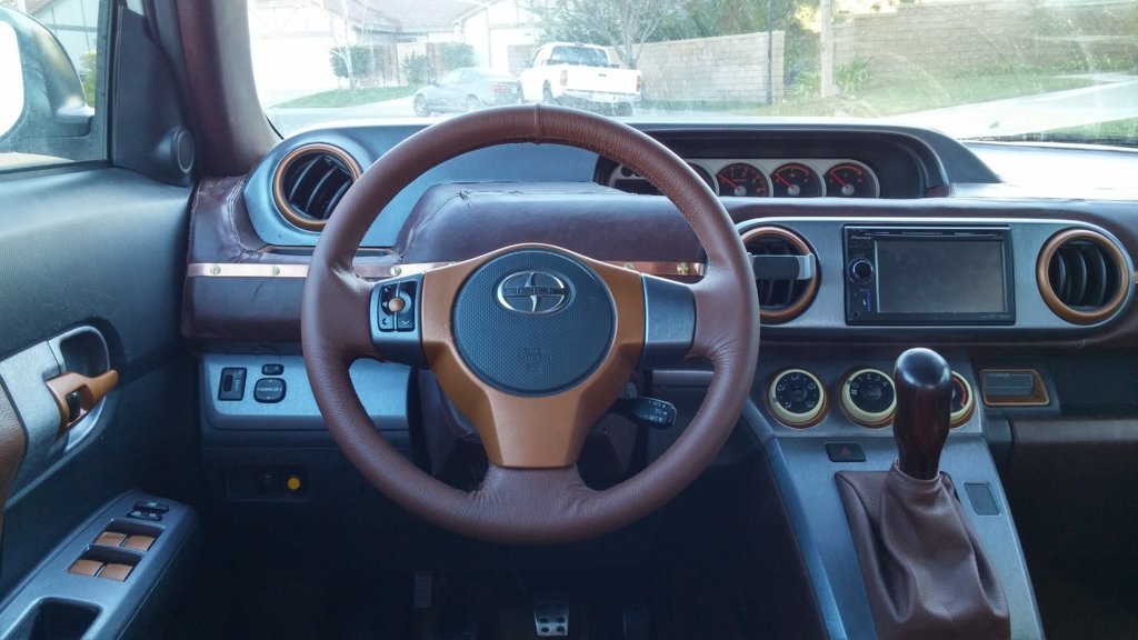

    Or alternatively you can just cut a strip of leather to fit and stitch it up nice and tight. I do not recommend doing this unless you have strong sewing skills. I did it in my last vehicle but I had the skills and more importantly didn't want to pay to do a full custom interior. The wrinkles were all worked out later, this shot was taken before I smoothed it all out.
