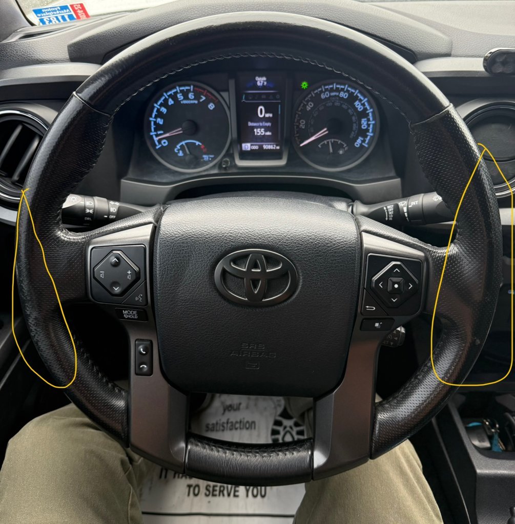

    Anyone else’s steering wheels kind of peeling or feels like it’s deteriorating? Any recommendations to fix or whatever thanks

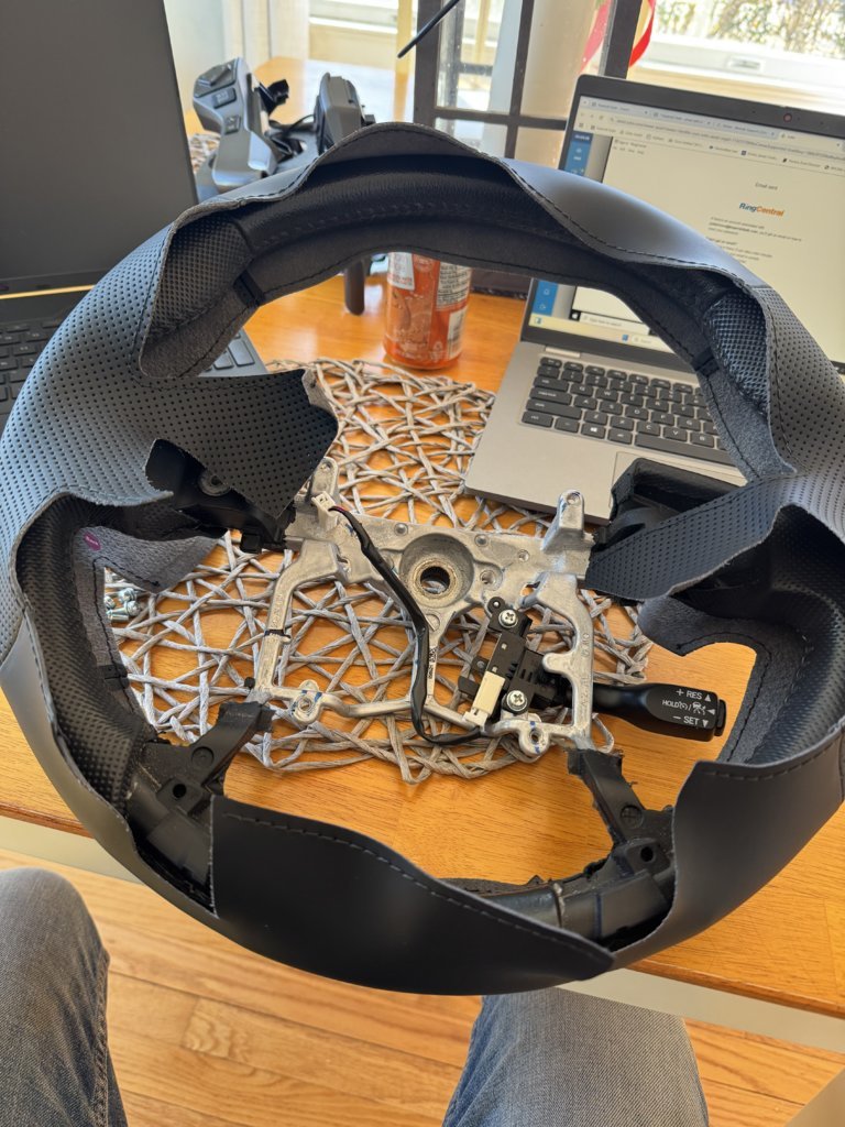

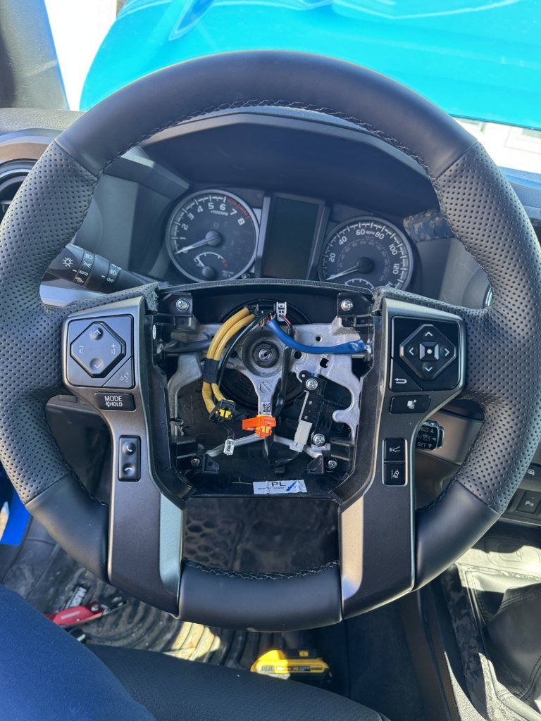

    I installed one of the DIY steering wheel covers off of Amazon, and the stitching wasn't too bad to get the hang of. I recommend removing the steering wheel first to make stitching easier.

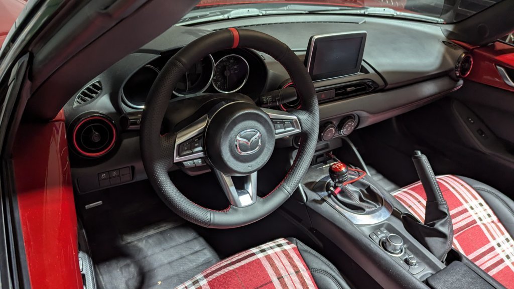

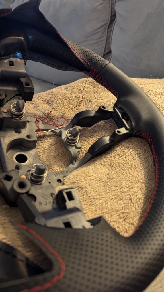

    I drive a Miata.
    Replace it or wrap it.
    I haven't done the truck, but I have wrapped up the car.
    20 buck purchase that feels like it should be 500 bucks.

    LOVE the tartan plaid!!

    are you sure it isn't just dirty? I can't tell from the pic if it is actually peeling. Mine was dirty and looked like yours. I used a chemical guys product with an old toothbrush to clean it and it ended up looking like new.
