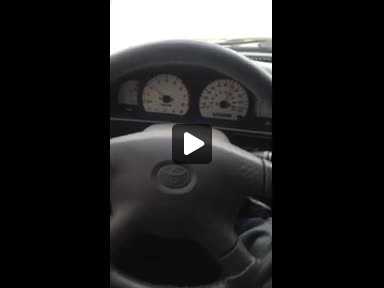

    Anyone have any experience with this? The wheel only has a bit of play at lower speeds but at highway speeds it gets pretty dicey. The alignment place said they think the rack is bad.
    The truck spent its first 30k miles on rough gravel roads, now has 69k.

    So before doing anything, I would do some static tests.
    With the truck at a stop try doing this same movement with the steering wheel. If the front tires don't turn at all its some sort of lash either between the pinion and rack bar, or the slip joint in the column. This would also point to bad tie rods either inner or outer.
    If thats not your problem (IE the front tires turn when the steering wheel is turned just a few degrees like in the video) then your problem is probably the rack guide or low caster.

    My alignment paperwork says 1.7 and 1.6 degrees caster. When stopped the wheel only has a very small amount of slop. It's at about 55 that I really start noticing it like this.

    You need more caster if you want a more solid wheel at speed, simple as that. Try and get that closer to 3*.
    What makes you say that? Have you already welded the slip joint and made sure your tie rods are good?

    Forcing me to spend more money! :p When I get my 33s I guess I will get another alignment and have them do 3*.
