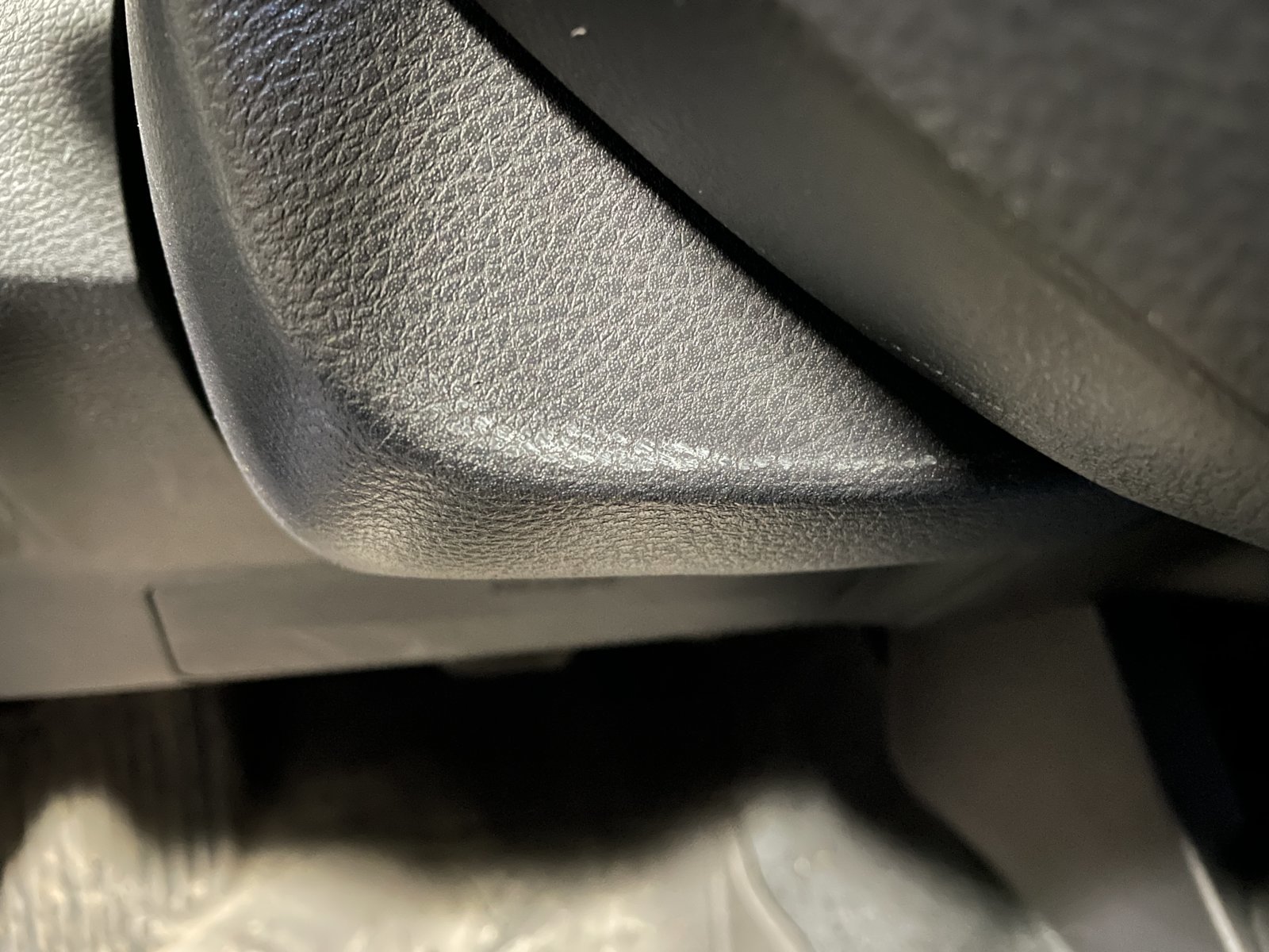

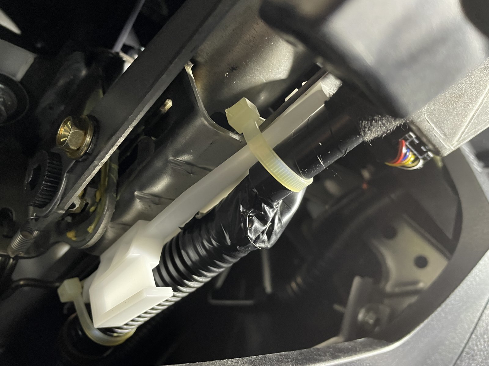

    Had the same issue on my 23.
    found that the white bracket that holds the plastic covers to the steering mechanism was very loose. Zipped tied it into place and also gave the lower claw a bit of help with another small zip tie. Lastly laid a small bit of felt on the bottom inner section as it was rattling. Put all back together and the plastics now don’t move and no scraping sound.
    mines a Mexico truck so go figure. My 17 did not have the issue.

    @commbubba19 I appreciate you posting this fix, going to give it a try as well. My '17 didnt have it either!
