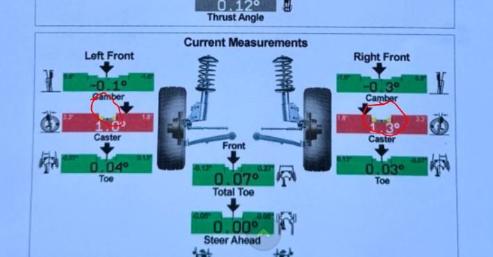

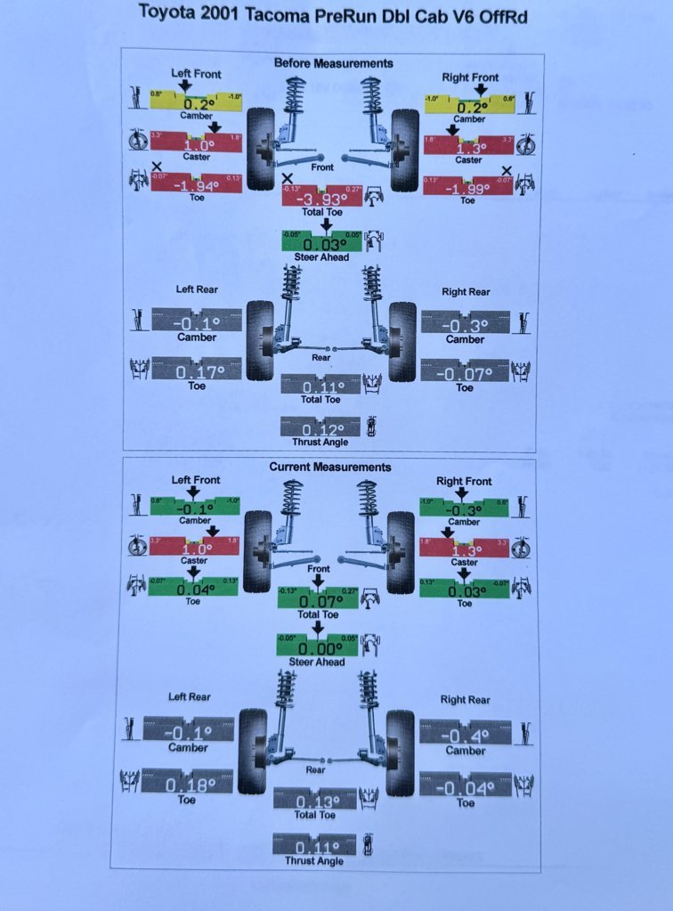

    @Wulf & @PathFinder1776 & @thomasburk - Here is the printout from the alignment - thoughts?
    Is driving this way bad for the vehicle? I am still not exactly sure what could be the issue..

    I think your caster setting is causing your steering not to return to center. If you think the shop is competent, return and have them adjust your castor to specifications [between indentation] in below pics.
    Driving this way makes driving uncomfortable, and slightly dangerous in my opinion. Which is not bad for the vehicle, until vehicle does not return to center from a 90 degree turn and you jump a curb and then you have to replace a LCA and/or other suspension parts AND get another front end alignment. :notsure: Then it might be bad for your insurance if you had decided to submit a claim to get it all cleaned up.

    Definitely needs more caster.

    More on the driver side, and less on the passenger side, according to the print out. :)

    Needs more on both sides. The caster reading is red because it is not even meeting the spec'd caster. FYI I have 5 degrees of caster on mine (lifted 2.5") and it is perfect for me.

    @thomasburk, thanks for the info! This is very helpful. From what I understand the Caster should be between 2º and 4º. Is this correct? Any recommendation as to what spec should be? I can't seem to find the exact numbers.

    If the shop can get you to at least 2 deg you'll start to see a big improvement on return to center. Since your truck is stock it should be reasonable to achieve if everything is in good order. Here's some info on specifications:
