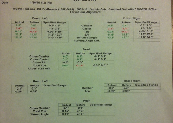

    Heres the allignment report from last saturday. can any one please help me understand if any of the numbers are wrong in there. The manager at firestone did say that they couldnt adjust the Caster anymore so thats why both actuals are pretty close to each other.

    there are a couple of issues. If I hold the steering wheel straight and drive on a flat surface, then the truck tends to drift to the drivers side. I have to hold the steering wheel a little turned towards the passenger side for it to drive straight. This is very noticable on freeway because I am driving faster there.
    The other issue is that when I am driving and make a turn on another street, the steering wheel is supposed to come to straight (horizontal) position. but this doesnt happen. it comes back but crooked towards the passenger side as shown in the first image. I was reading some stuff today and it said this might be happening because the Caster was out of spec

    I used to work at Firestone, well quit recently. I bought 4 tires & did my own alignment. Everything was dead on (Camber, Caster, & Toe) but steering wheel was crooked to the left. It annoyed me.
    Then it hit me that when I bought the truck brand new, the steering wheel was also crooked to the left. Took it back to the dealer & get it fixed.
    Apparently, prior working at Firestone I worked at Lexus. All brand-new Lexus GX460 steering wheel is crooked to the left.
    So only way to fix it is have to set the alignment with steering wheel BARELY slight to the right (JUST BARELY). Vehicle drives straight & steering wheel is straight.
    Took my truck to my friend shop to see if he can set my alignment & same thing. Steering wheel is still off-centered. His alignment machine was recently serviced & calibrated.
    Just tell the technician to set your alignment slight right. It will compensate road crown as well.
