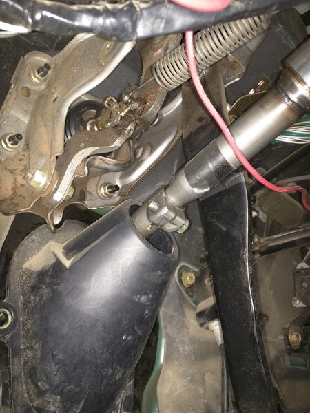

    Quoting myself here, because this is very simple guys. And I'm trying to remember the steps it took me to do it. Also remembered that I think I had to loosen the top part of the intermediate shaft as well that connects to the steering wheel column itself(accesible under the dash). So.. There's the bolt above the rag joint, that locks down the intermediate shaft to the rack, and the top bolt that locks the steering wheel in place. Both have shafts with splines and they will both need to be loosened, so the shaft can be pulled up out of the rag joint, so you can turn the wheel freely and straighten. Then slip the intermediate shaft back into the rag joint and tighten up both those bolts. Very easy. Shouldn't need to remove anything. Both those bolts are easy to access iirc.

    This bolt? Or the joint where it connects under the black plastic cover?

    That bolt. But looks like it's as far back as it'll go already. Hmm. I'd still loosen it so it slides and has some play. Should be able to lift that shaft out from the rag joint.

    Shaft isn't moving at all. I think I'm either gonna have to take the upper steering column out and unbolt it at the firewall to pull the shaft from the rack, or take the whole damn rack off again to separate that lower shaft from the rack. I'm so annoyed right now. Never letting a shop touch my truck again.
