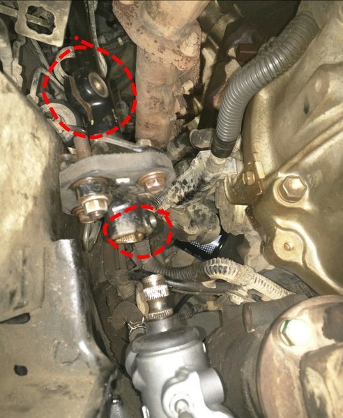

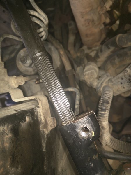

    Almost got the shaft all the way out...but noticed it has a flat section where the bolt goes thru, so I can't turn it and put it back in, the bolt won't go back in if I do.

    Can I unbolt where it meets at the rack? Either the two bolt on the upper part or the lower where they meet?

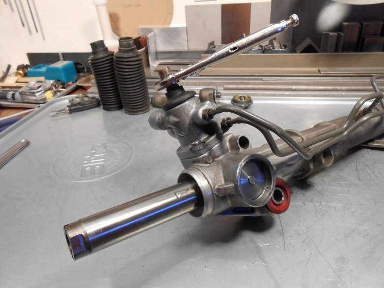

    See big blue text below. ;);):):D

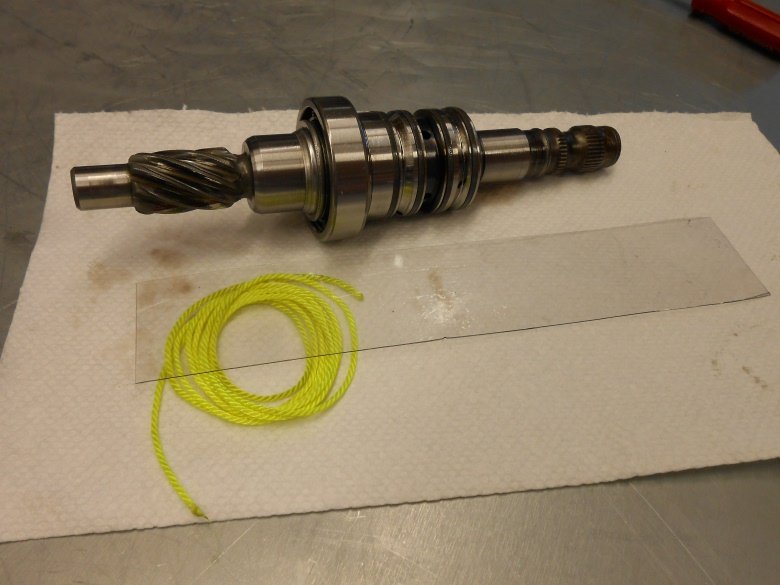

    Check out these shots of the splines at the rack (control valve shaft). First shows vice grips gently gripping the shaft to turn it (on the bench).
    Second is the shaft itself (removed from rack). Note how short the splines (right side of pic) are and that the relief for the bolt goes all the way around the shaft.

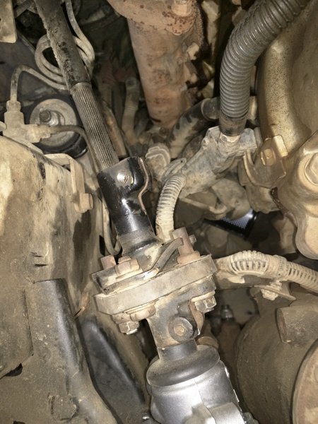

    Have it disconnected at the rack. But the wheel doesn't have a "lock to lock." It just keeps spinning and spinning.
  19. Oct 1, 2016 at 5:59 PM
    #39
    lonzorizo
    lonzorizo [OP] Well-Known Member
    Sep 5, 2010
    #42784
    1,405
    Lonnie
    Hoopa, Ca
    2003 TRD OR, 2016 TRD OR Tacoma

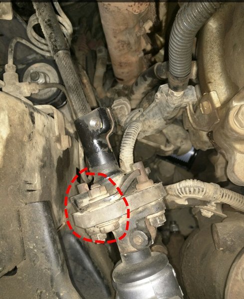

    I got it straight. It was super easy after I figured it out. The truck doesn't need to be on jack stands. Just need to loosen two bolts and it separates.
    Found this out after taking my steering rack off twice in the last week. And taking the skids off, and dropping the diff to get the driver side rack bolt out.
    Live and you learn. lol. I spent hours and hours trying to figure this out and it turned out to be a 10 minute fix.
    For anybody who goes through this, all you need to do is unbolt these two bolts in the picture attached. Then the shaft will separate from the rack. I drove in a straight line a couple times, parked, undid the shaft from the rack, turned the wheel straight, slid it back together and test drove driving in a straight line again. Did it about 3 times till it was straight. Then bolted it back together, easy.

    Aha! Told yaaaaaaaa.. Well kinda. Ha. I just remembered wrong. It had been a while since I did that myself. Now that you posted that pic, I remember that's what I did as well. I think I loosened the top column anyways but was probly not needed iirc.
