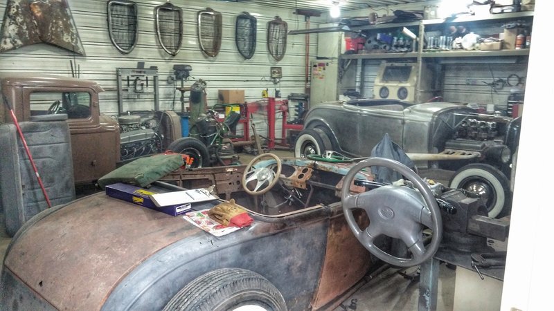

    20170222_105302-01.jpg Just an update to my scenario. Brought in for a alignment check. It was way toed out after the dealer did the frame and shitty alignment.
    New alignment feels better but still wandered at highway speeds. Constantly felt the need to correct my steering.
    I pulled my wheel and shaft assembly out and welded the shaft. Holy moly does it feel better! The steering is really tight with no slop.
    I didn't disconnect the shaft from the wheel, just welded it with everything in place. The biggest pita was the tilt springs.
    I'd encourage anyone who's steering rattles or wanders to do this tack weld mod.
    Here's a pic of my buddies shop, where I welded it, just showing off his hot rods
