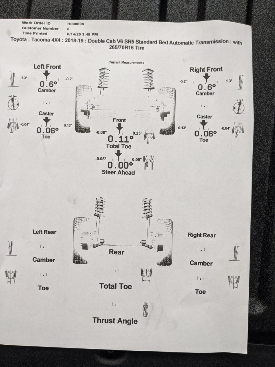

    Wow. Non-existant caster. That's probably your problem. You need to be at least 2 degrees positive. Even more would be better for fitting w/out rubbing.

    Yeah the caster and cross caster measurement is what I was looking for and its not on the report...does the steering wheel feel floaty or lite when driving around at speed?

    Yikes that is some low caster. I bet it is all over the road and probably look like a lumber jack sawing the steering wheel back and forth to keep it on the road.

    So much wrong here. The lack of caster in the first place could have caused your shake and the pull you had after the lift but before the alignment is normal and correctable. All that the shop said about doing the alignment is wrong. Sounds like they were will to sacrifice caster to get camber in spec, which is more of a tire wearing angle. There's only one way to do the alignment and that getting it as close to factory specs. Yeah you may want more caster to clear the cab but that's it. You may need new UCAs to correct the loss of caster with the lift. Oh and you want cross caster no more than .5 difference from the other side with the larger angle on the driver's side to compensate for road crown

    If you have new UCAs that compensate for lift (like most UCAs do) and they couldn't get you more caster (assuming those readings were accurate) AND said they couldn't get one angle in spec without taking another out of spec then I'd say they aren't sure what they are doing.
